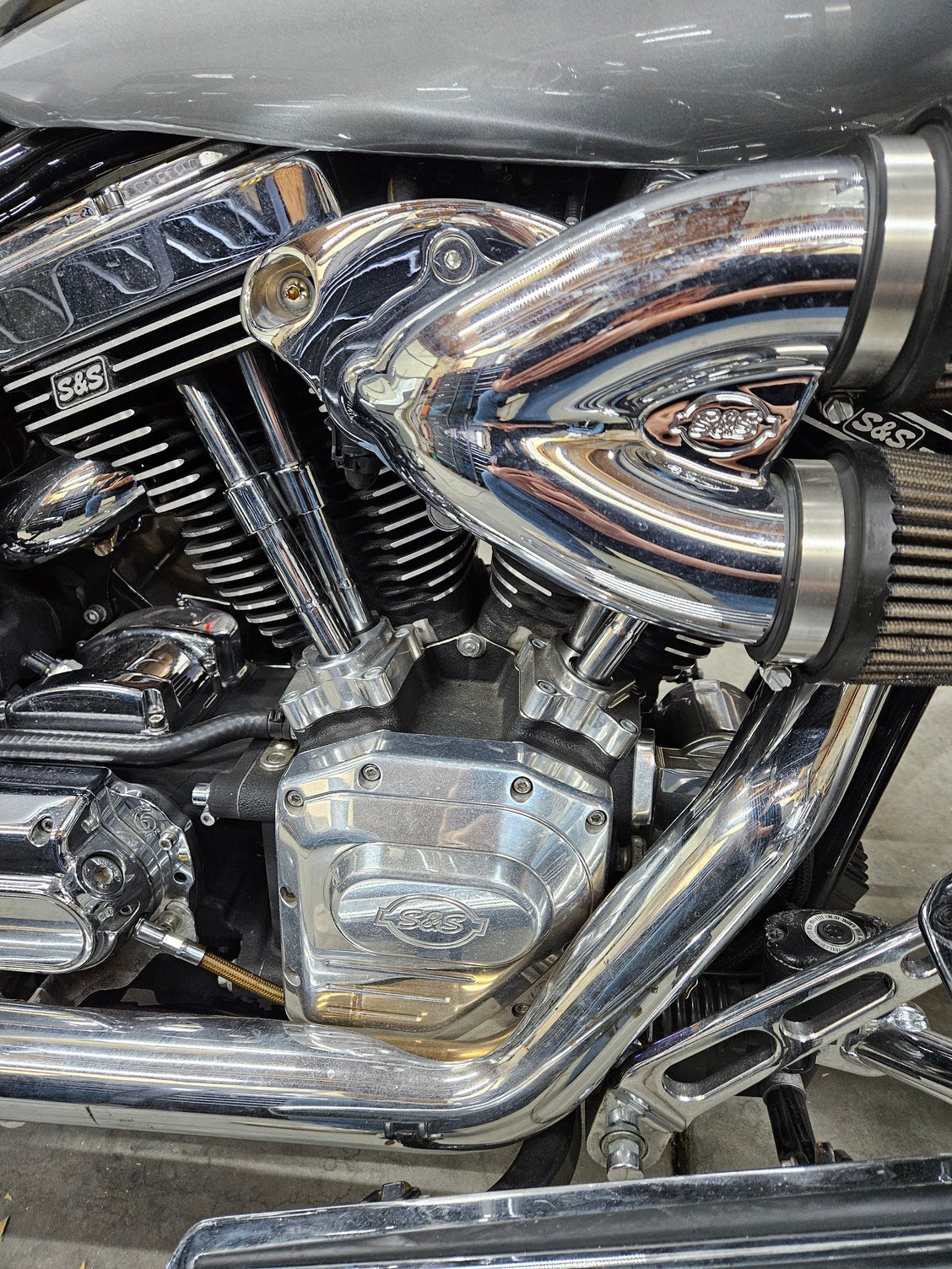

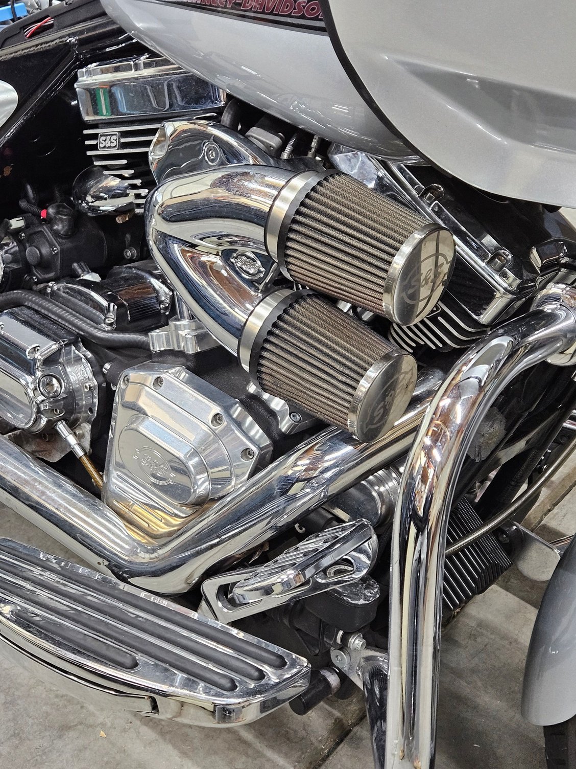

Has anyone had experience installing an oil temp sensor on the S&S T 124 motor since its oil routing takes over the usual oil pan location? If so what fitting and location did you use?

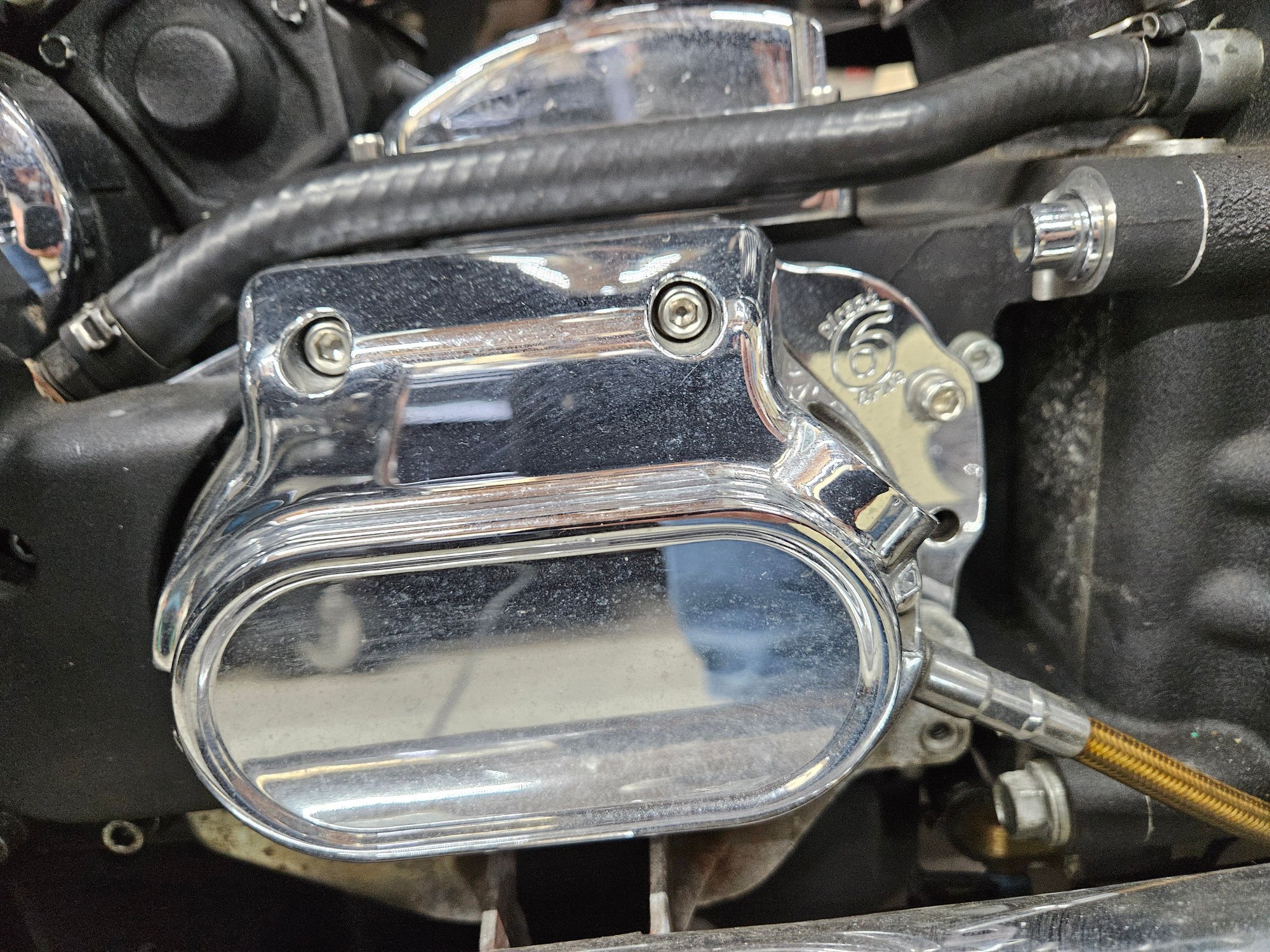

No, to avoid legal issues S&S rerouted oil lines, both the standard plug and drain are used for the motors supply and return lines

Not sure if there's room down there to put a "T" fitting in at either the supply or return lines to install a temp sensor, but then again, I don't know if I'd really want to possibly impede the oil flow either.

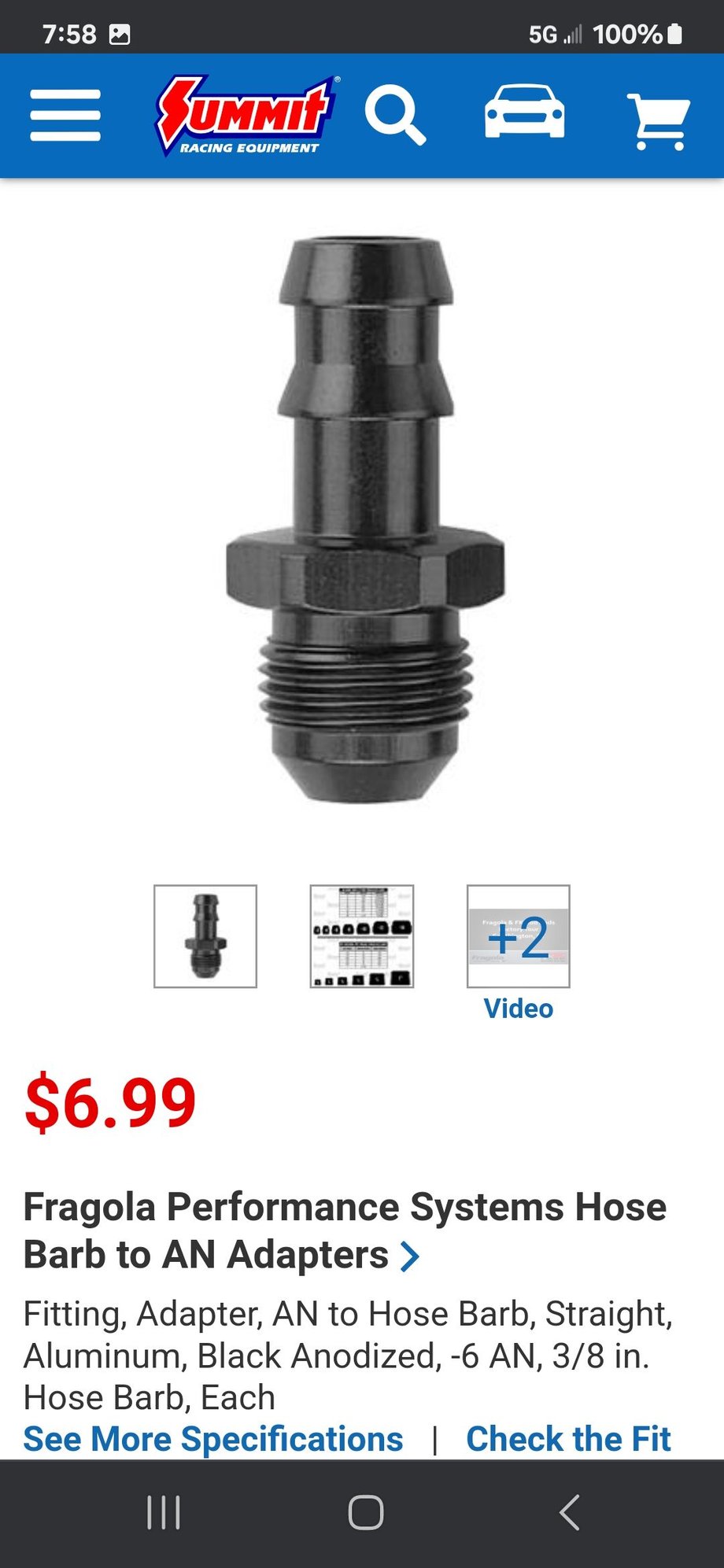

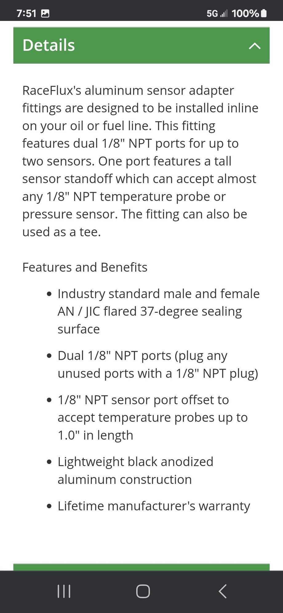

If your running a oil cooler which you should be with a 124, You could add these to one of the lines going to the cooler.
