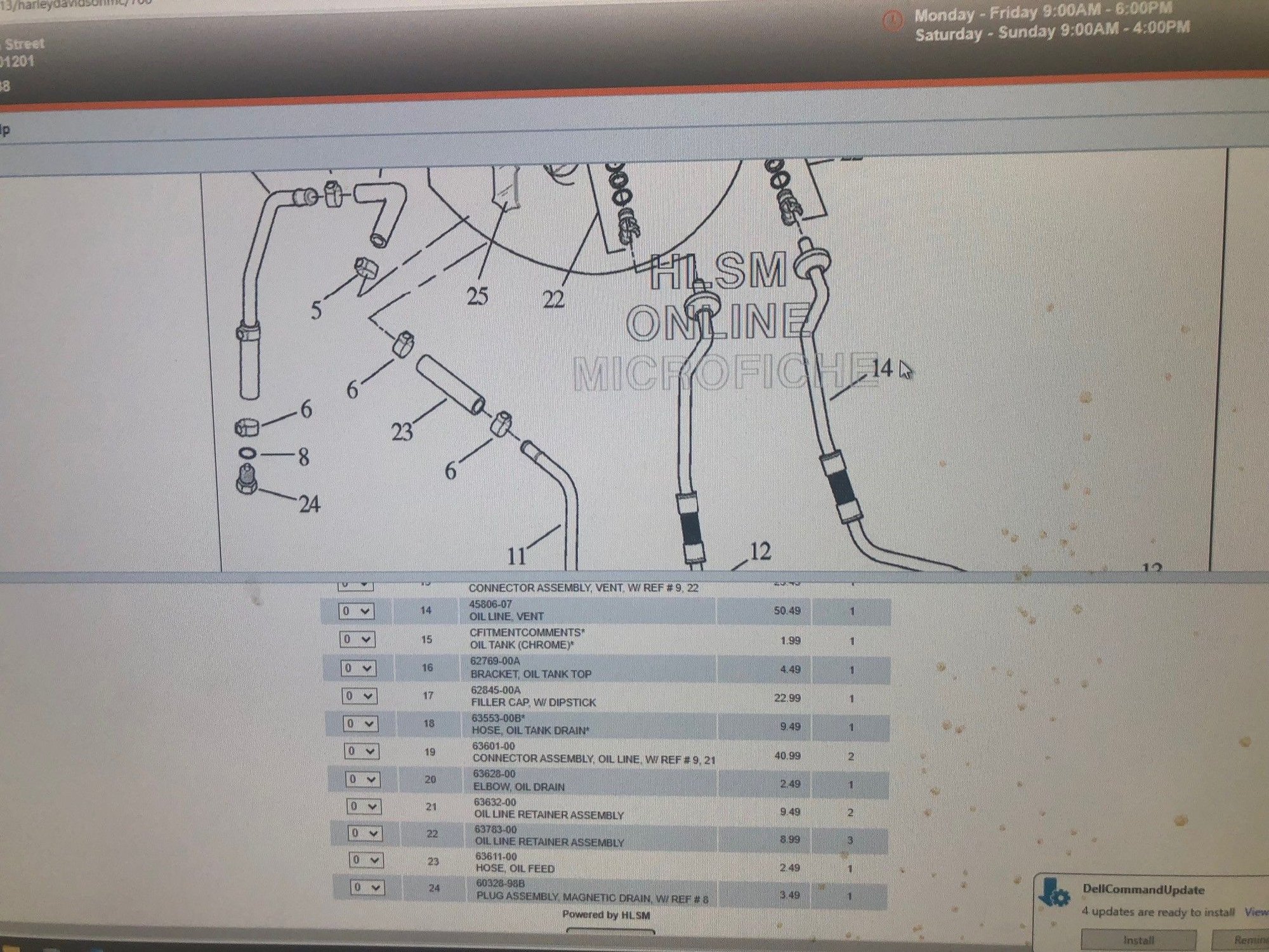

2008 Fatboy TC96.
I want to add a dakota engine oil temp sensor sen-1044. 1/8 NPT thread and comes with 1/4 adapter. Thanks

Can you interpose a T into #23 ?

[QUOTE=hattitude;21118978]I have never done it, but I would suggest putting a "T" in the case where the oil pressure switch goes... That way you will get proper pressure right from the oil pump...
He wants temp not psi

A shop that sells hose and line fittings and adapters should be able to help. ( Summit Racing etc...) You could try adding a twin port manifold where the oil pressure switch is located and have the best of both worlds.....pressure and temp.
