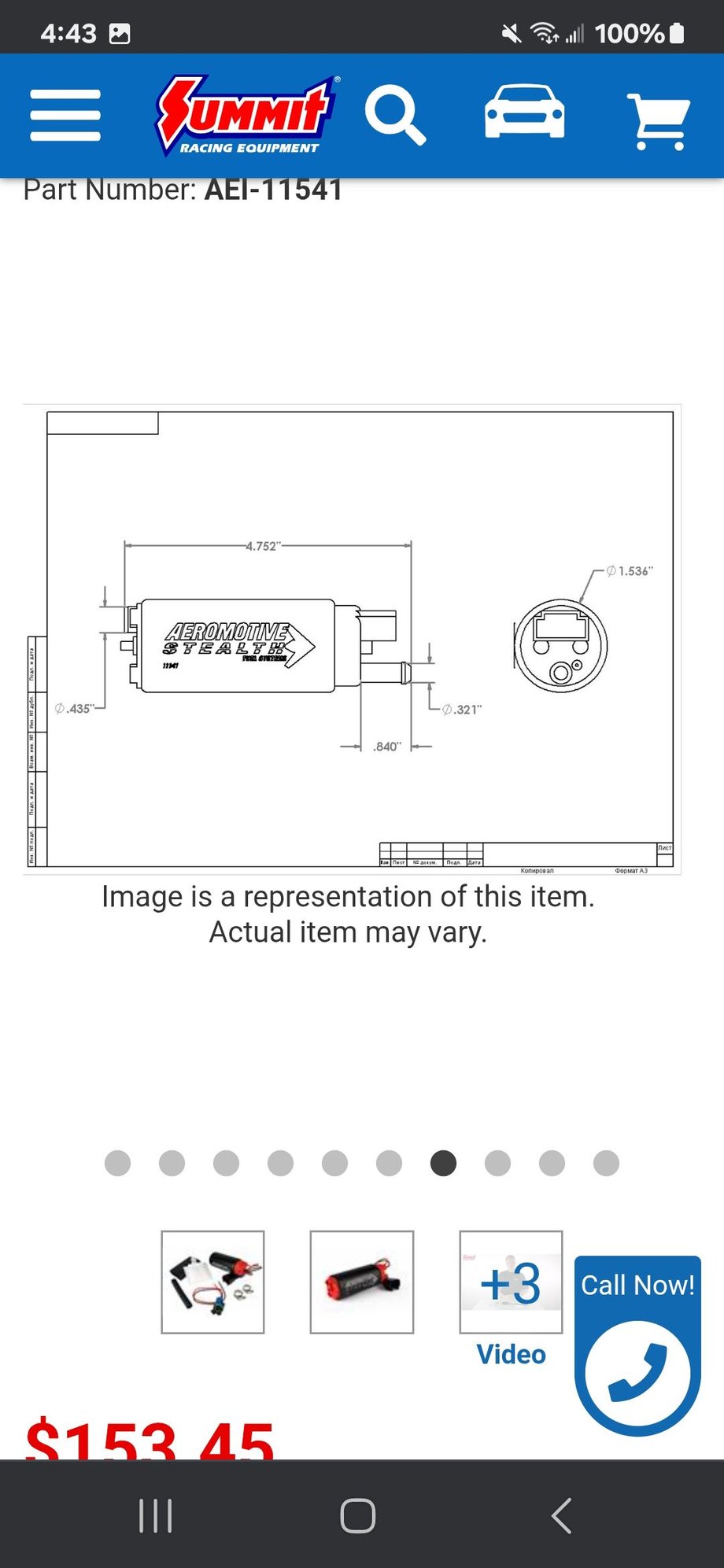

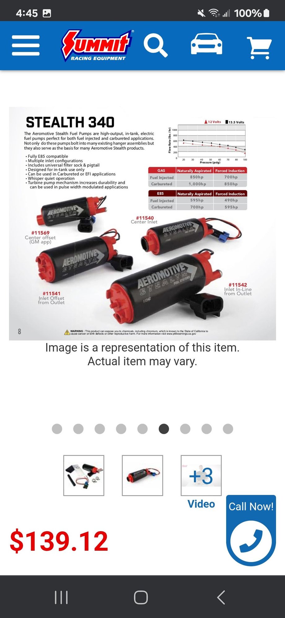

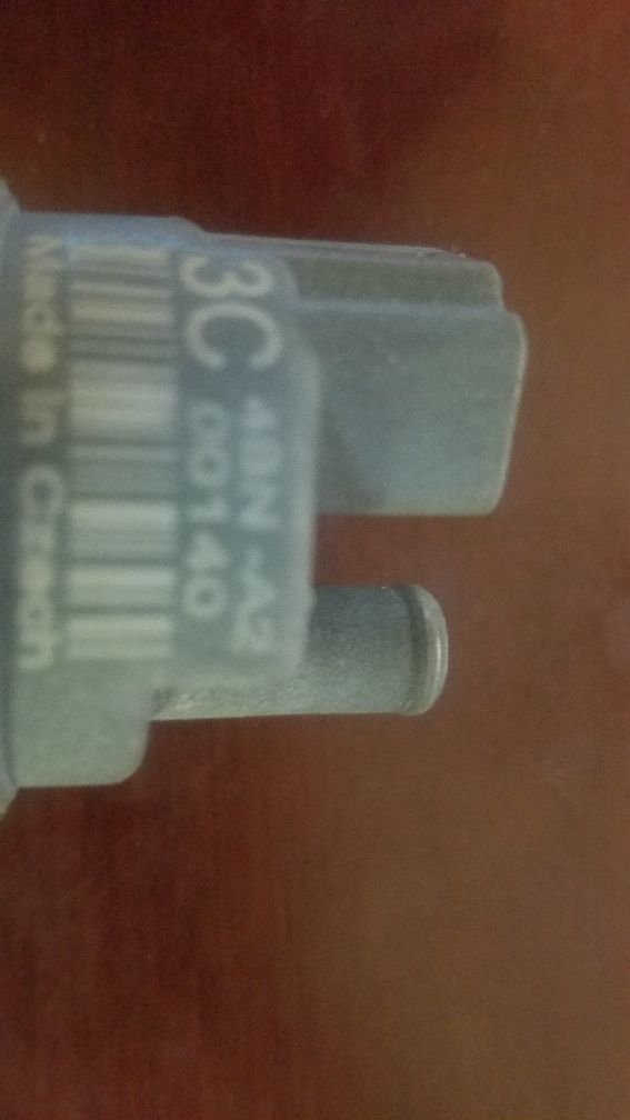

I considered OEM but when I checked availability, PN 62897-01B came up obsolete; also $256. Photo of the OEM pump is attached; made in Czechoslovakia. From what I can determine, Quantum pumps are manufactured in Ventura CA and everything I read about quality, customer service etc. is good. I read on another forum that the FPF pumps are made in China. I am a member on HTT and the Aeromotive 11540 is suggested as replacement more than once but when I checked it out, a new sender is included so I am not sure about that one; not interested. So I am thinking Quantum would be a good replacement.
The number is blurry 3C 48N-A2

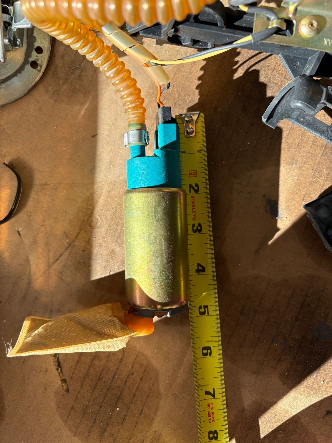

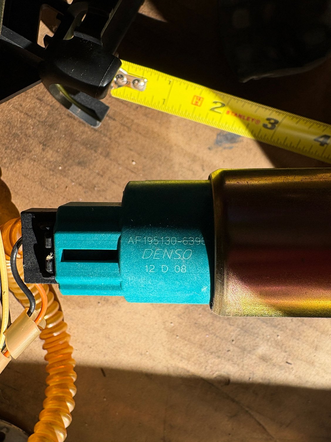

I pulled down all my pumps and pulled my notes on specs. These specs are for MM& Delphi touring bikes of that ERA, but I believe the pump is the same for your bike. I took a pic of the pump next to a measuring tape so you can compare. One of the pumps had the same markings as yours with the made in Czech.
My notes indicate Spec is a Denso Pump Part# 195130-6390. This matches the P/N on the pump I took a pic of. Another note I have says Model H3861. AFCO may have also been a supplier of the Denso part.

The Aeromotive 11540 is the center inlet pump.
The 11541 is the offset pump that i almost bought.

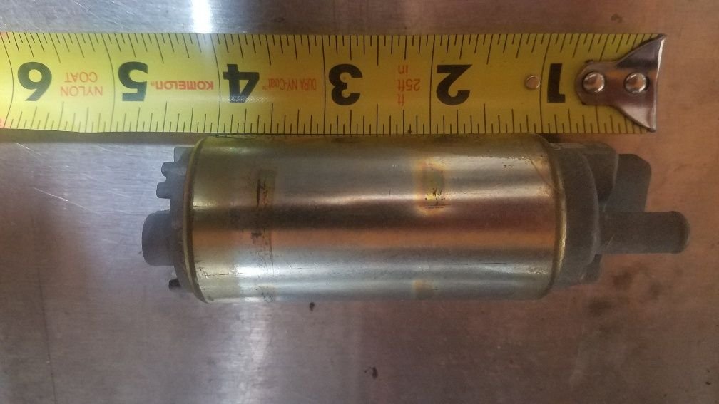

Photo of my pump length which is shorter. Now I am seeing another issue; making sure I order a pump that will fit in the housing. FPF is suggesting I test the regulator first but other than checking the fitment of the regulator in the housing or the possibility of a crack in the housing, I don't know how to test the regulator. I have the OEM regulaor and I suspect it is probably good but I don't know if there is a bench test for it.
I do not think yours is shorter looking at both pics. Both look like about 4 3/4". I could take it down again and get a better pic.
