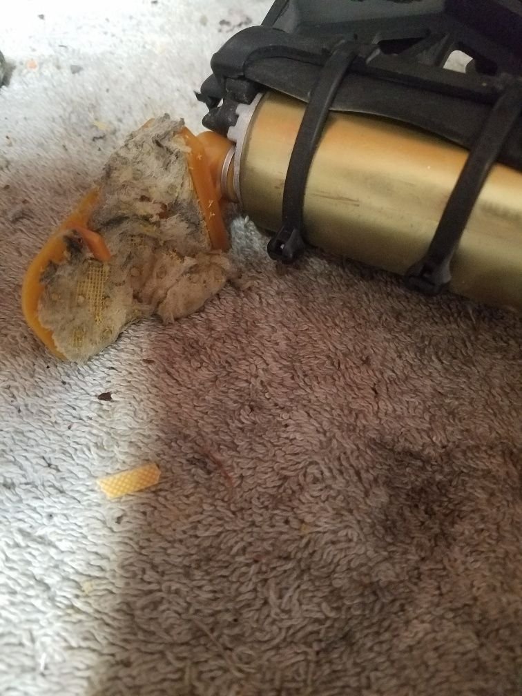

Maybe but if you will recall the filter sock had completely disentegrated and there was very little of that material remaining in the tank so most of it probably landed in the filter. No way will I complete a do over with the old pump and I won't be using another FPF pump unless it's free. I still have to pull out the assembly and see what's what, more to come.

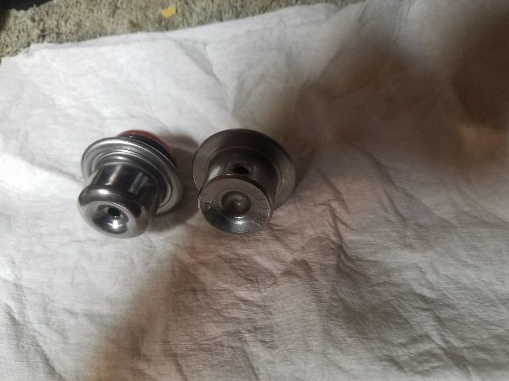

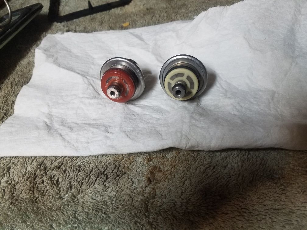

Originally Posted by Ed Ramberger
I would use the old pump or a good used one and find a new sock. I have read and know personally people who got bad FPF pumps out of the box. Only other thought is a bad o-ring on the regulator or filter, or bad regulator.
Ed, I have attached pictures of the OEM regulator and the FPF regulator. They looked different so I sent the photos to the FPF and they confirmed that the regulator in the kit was correct.
I am afraid of the OEM pump now; I want this redo to be the only one but kind of agree with Bob (98hotrodfatboy) that the broken exit line might have been the failure and repacing that line and the sock would have been the fix but WTFDIK?
