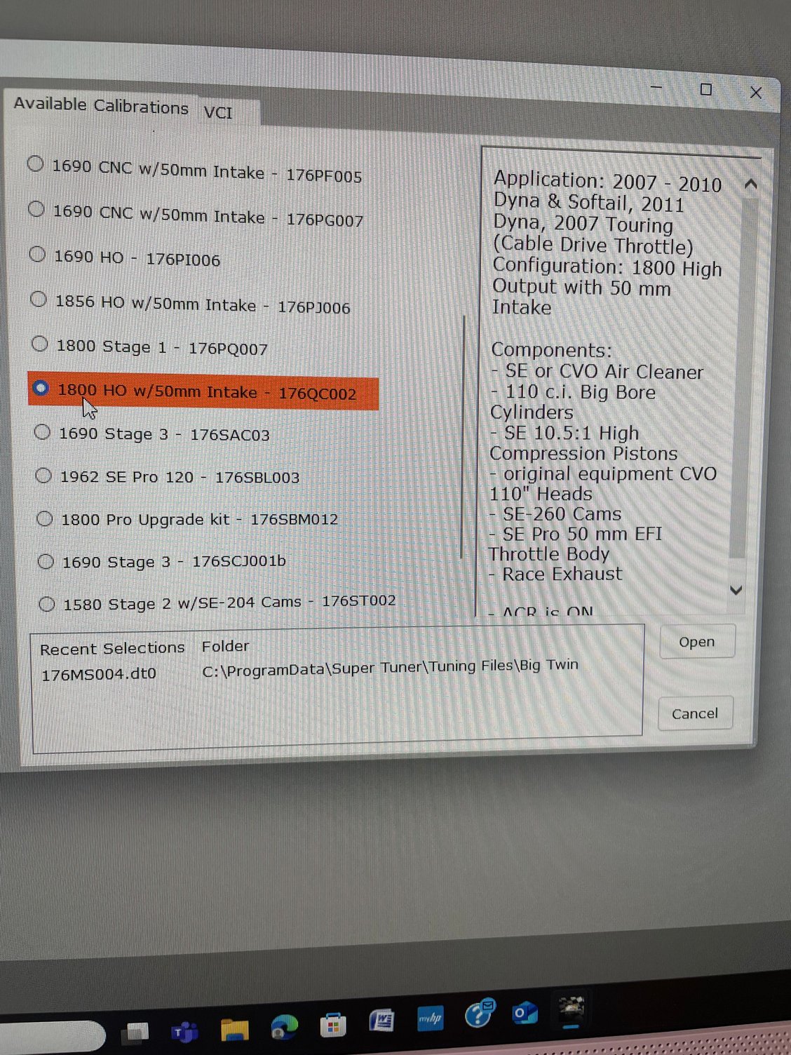

i thought that idea, but the sepst Dosent have map for it, I need to change the tuner maybe?

Sorry, I didn’t realize they don’t offer the tire shredder kit for your dyna and have a calibration for it. If your tuner isn’t the “street” tuner it could be tuned using the one you have, but you would need help from someone to set it up then work through the process. The cvo heads and dome piston option wouldn’t be a bad setup just super expensive.

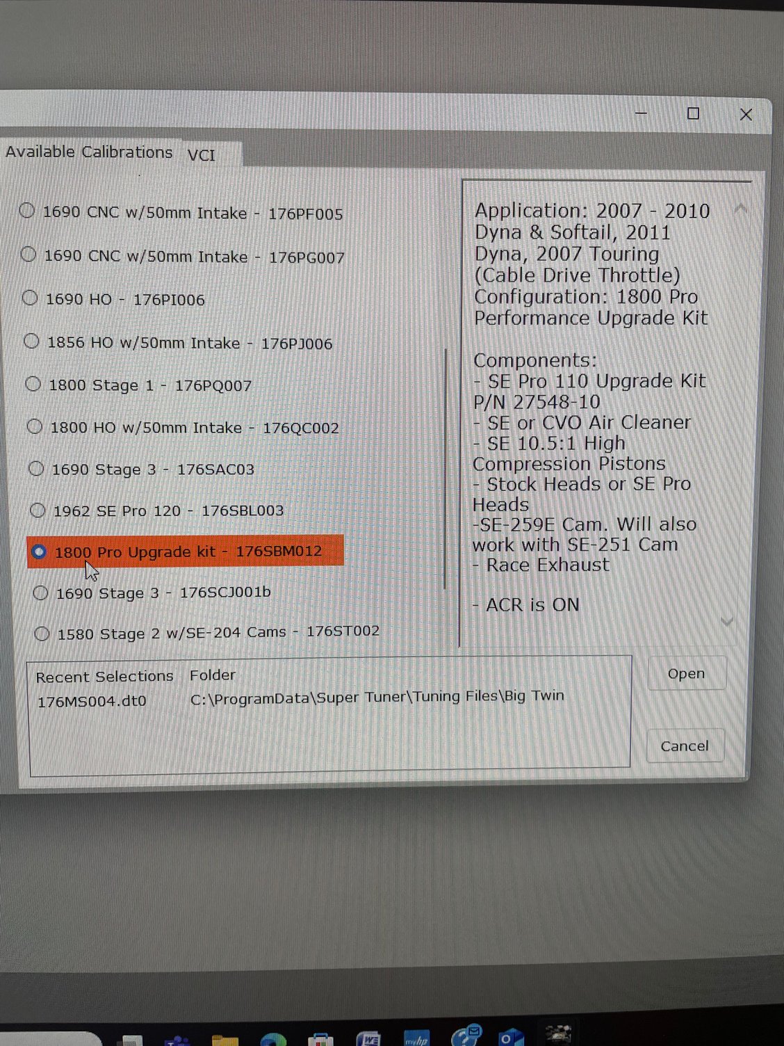

I dont know if I install the kit 92500039 with my heads will give me the 10.5:1, and maybe use the same tune of the high compression kit. and use the se259 cams.

Yes then I would use smart tune to optimize it the best you can. With the gaskets in the kit you would have about 10.3, and substituting .030” head gaskets would make it about 10.6
