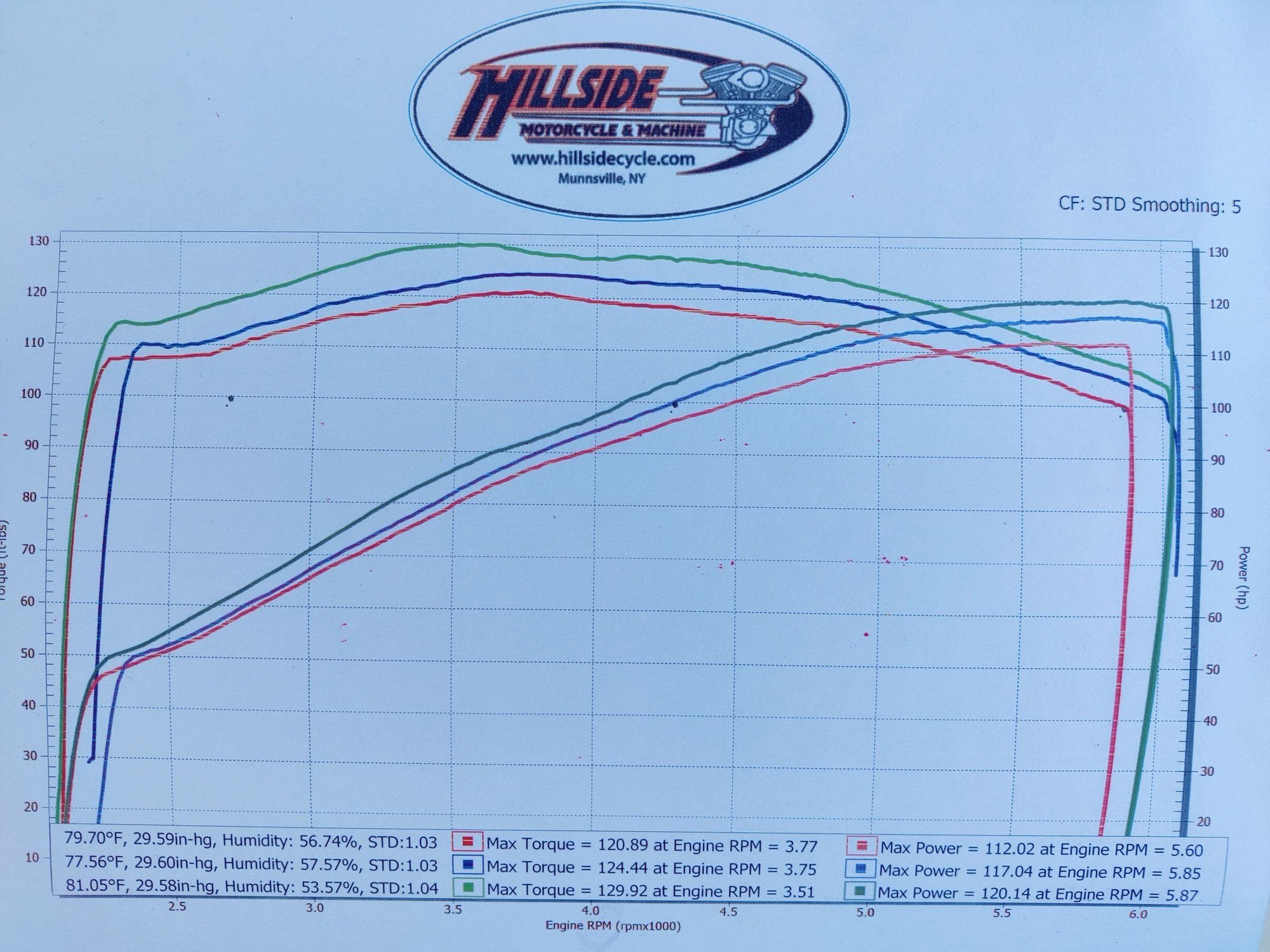

Ed is correct.. It's the low end power, Hole shots.. On my 110" build I was making very good power.. These wheel sets can take more than they used to early on.. I pushed my build pretty hard especially at the track and never an issue.. I always had .0055" of runout on the pinion and since I installed the S&S tc3 pump and cam plate and pinion run out actually went down.. I believe cam plates with bronze bushing are better than any other.. The sheet below was done 2 days before I ran it at the track in Cicero NY.. One thing I will advise is to use loctite on all rocker assembly bolts and properly torque.. I just brought my 117" build home yesterday from Hillside Motorcycle and Machine and will be assembling it shortly.. I did install an S&S set of wheels this time.. I'm expecting 135/135+.. Cheap insurance.. Depending on how you ride will determine longevity.. I believe stock wheels can handle 125-130 lbs. of torque without issue..
