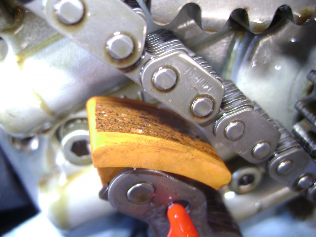

here's my tensioners at 25K very little wear but some small chunks out of the wear surface

Pretty common-looking. Those little pieces of missing plastic are "hopefully" being caught by your filter, but they are going through the scavenge side of the oil pump then picked-up from the pan and sent back through the feed-side of the pump. I'd cut my filter open and take a look, or even better....go ahead and do something serious with the hydraulic upgrade or gears....then not have to worry any longer.
Some of us actually go so far as to drop the oil pan and clean it very well before we do the conversion. Those little plastic shards hide everywhere once they flake-off the shoe.

Hey TARPONROD, check your inner tensioner too. My outer tensioner looked similar to yours ( a tad bit more wear) but when I checked the inner one, it was worn 3/4 down. So I'm replacing them this winter with the hydraulic ones.
Seams that the inner tensioner wears faster than the outer one! FYI bro.
