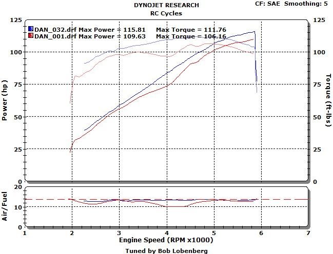

Closure, I'm bringing up an old thread as not to leave it hanging. After issues with my original 95" build. I gave it up after 9900 miles.
see here:
https://www.hdforums.com/forum/engin...plug-hole.html
I went with a S&S 97" kit & 570 cams, Dyno Tune. I'm happy now.

Mark Lukas actually tuned it. I told him he needs to put his name on the dyno sheet, but he didn't. Mark had the patience to do it right. It took about 4 hours to tune. It wasn't easy to find some that will tune the S&S VFI system.
