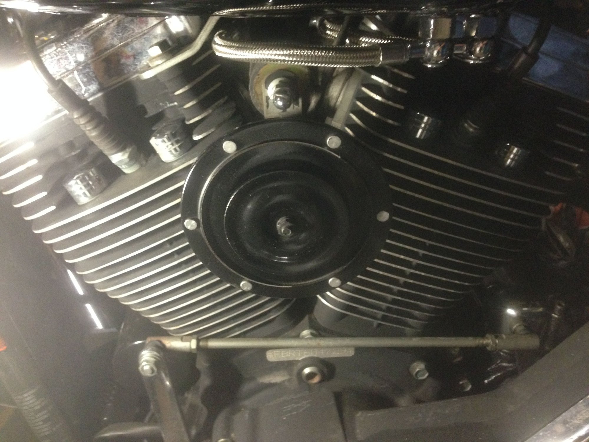

Well I used the old Mercedes horn as it has a 2 blade connection like the stock horn. It sounds at least twice as loud than the stock horn.
You have me wondering now about relays. Where can I pick one up and where would be a good place to mount it?
I did not check the amperage draw on this one so maybe I better do that before I go too far.

I don't know if I did that right with the picture but here is a shot of the horn installed. It's really not much bigger than stock but is a lot louder.

Thanks Yankee Dog, this horn is loud and does get attention. It made my ears ring while riding after I honked at someone. I like the sound from the '57 low tone horn but there is only one blade connection. I think if I attach the ground blade to the body of the horn it will work. I'll give it a shot one day soon.

Ok, it took awhile but I finally got all the parts together and wired the old Chevy horn up with a relay. Nice. That horn is freakin loud. Now I'm thinking about how to mount up the other half of this pair..
