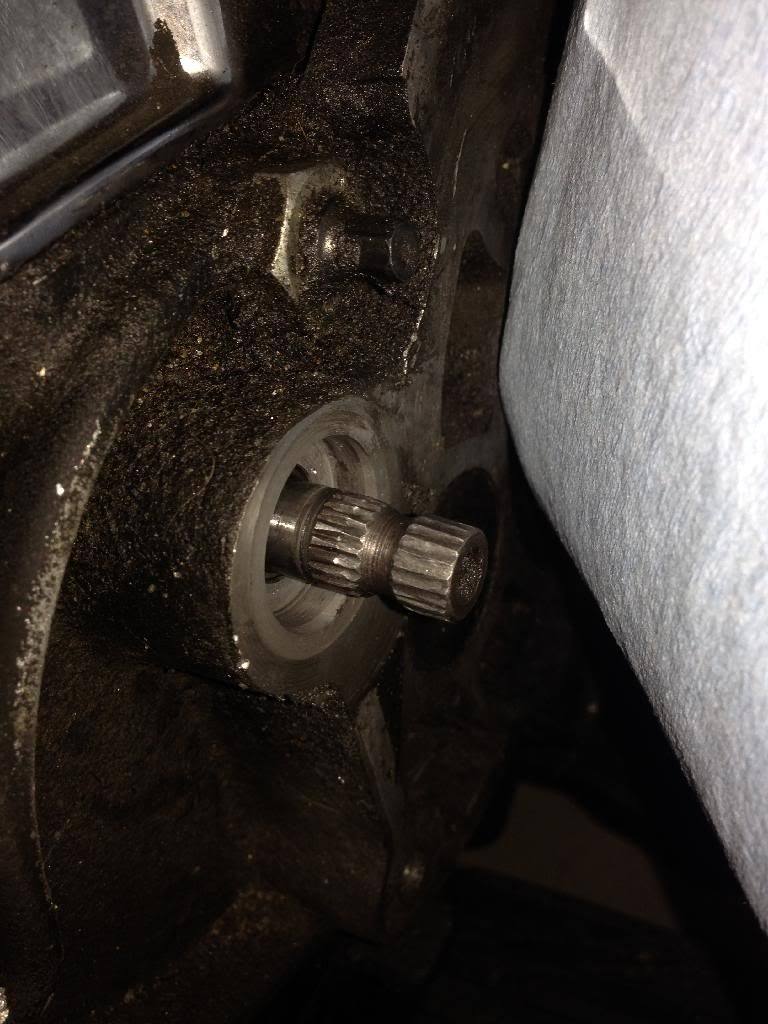

I like the look of the betterlever, so I ordered one this morning, then this afternoon, I used my dremel tool and cut the old lever off, now just waiting on the new lever. The splines on the shaft look good, the aluminum lever was worn out.
I can't believe that the original lever only lasted 18 years, and 82,500 miles.....

I received the Better Lever today, and 10 minutes later it was installed, feels solid, will just have to see how well it holds up.....

The first one I ever fitted has been there for 40K miles with no issues and the splines on the shaft were not too flash when we did the job....so I guess you are good to go.
Ironheads didn't use splines, the lever just gripped the shaft...at least the better lever has something to grip onto.
