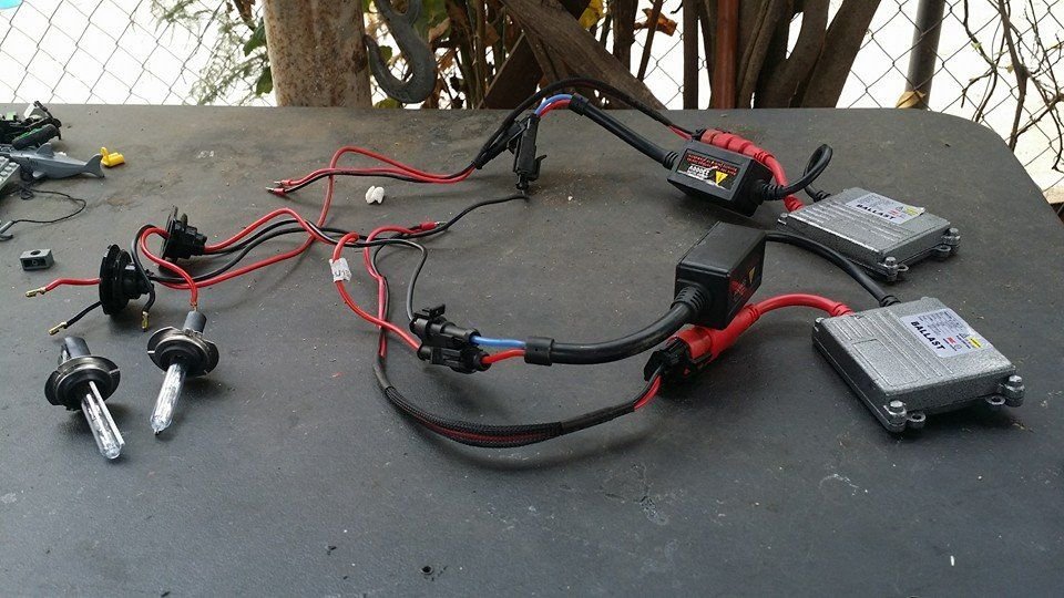

What about this one:
Saw this on an FB group and the seller asking for $75 (both pair). No other explanation but "SET OF XENON HID BALLASTS AND RELAYS".
Would this works for my Tour Glide and won't take a lot of juice out of it?

Those look to be low beam only. That would eliminate your high beam. I think you can get a set that is high beam regular, low beam HID, or maybe HID both, but not sure about that. Look on Amazon.com for an HID system for the bulb type you have.
I put a similar kit to that on my RAV4 a few weeks ago. $40 on amazon, delivered. Low beam only.
