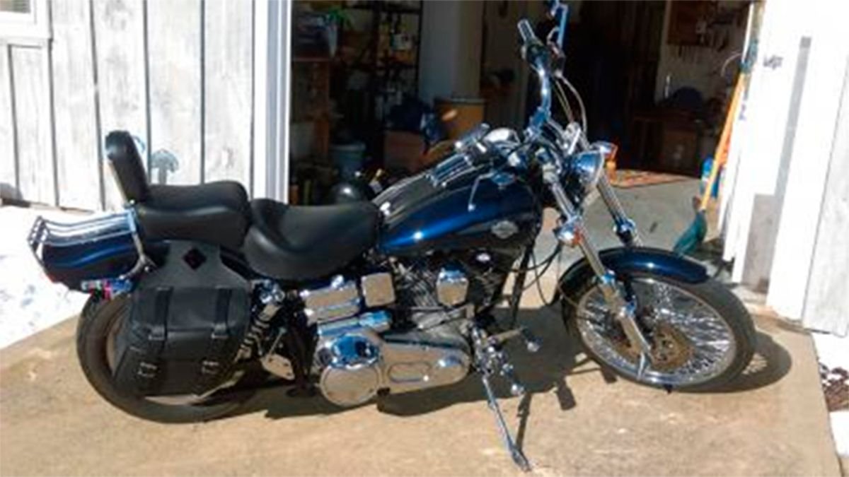

Originally Posted by texashillcountry
ps I like the right side primary, horn, and kickstand in your sig pic!!!
I just caught that. That is a special bike right there. No wonder his oil pressure is low. Everything is backward.
You should see me back out of a parking space.
Old Mar 18, 2015 | 03:55 PM
  #34
glidein wide's Avatar
glidein wide
Joined: Jan 2015
Posts: 2,504
Likes: 150
From: ct
Front wheel drive also ?or is that five gears in reverse ??

I thought we fixed that pic for ya a couple months back in a different thread?

Is that bike for the other side of the planet or are you left handed and footed.
Aboot da same as yours lad...
Holy F*%$ !!! LMFAO!! never seen such a thing, some camera man. I'm still laughing!!!
