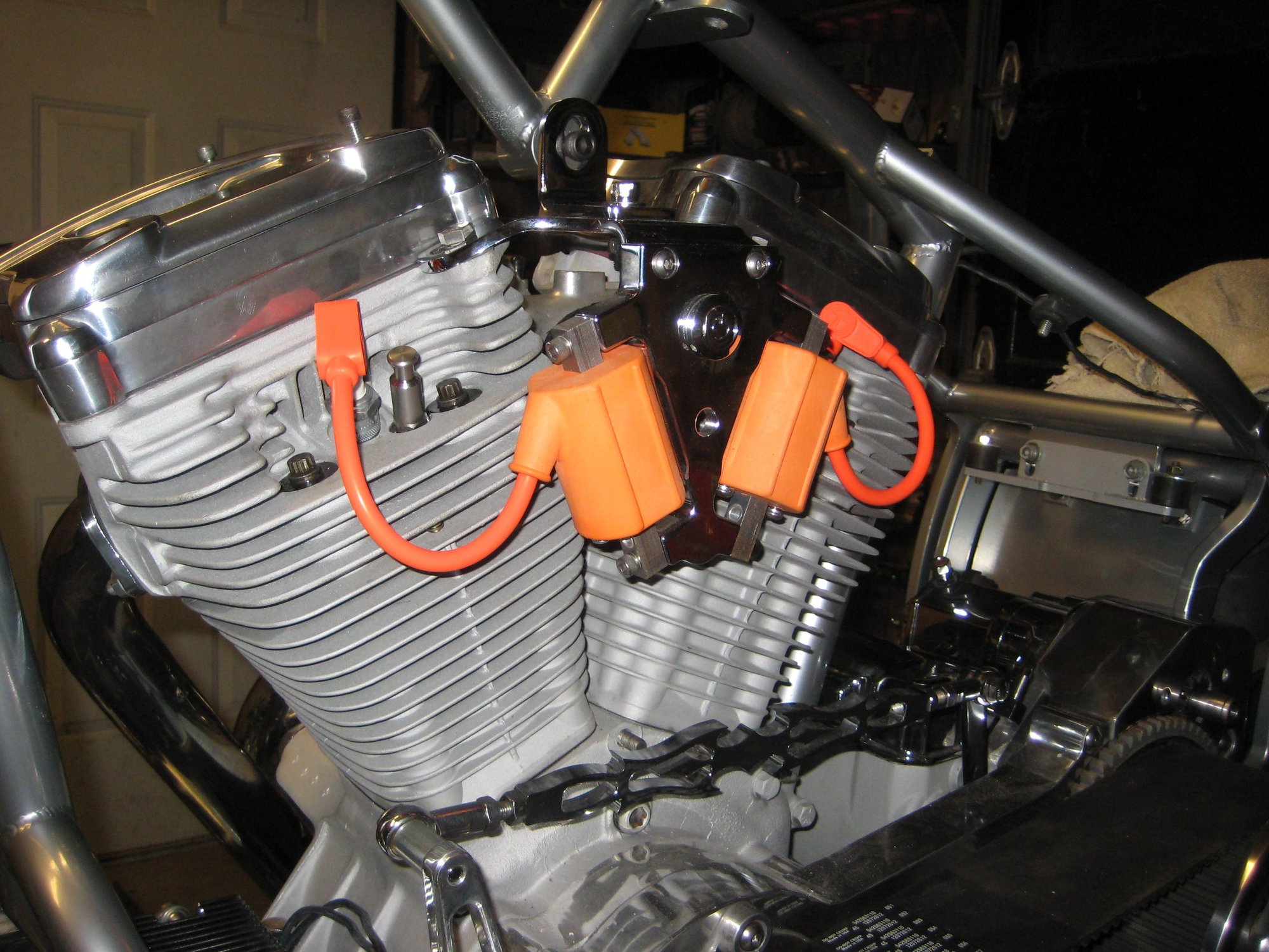

i will agree for performance the duel fire is just as good as single fire no gain either way.
i only run single fire because it looks cool with 2 separate coils
Ok I'll give you that single fire is prettier.
It is easier to figure out if your coil is bad with a dual though.

Looks awesome, but the S&S single don't look like that , two coils in one casing, not too different looking than mine. Yours much purdyer.
