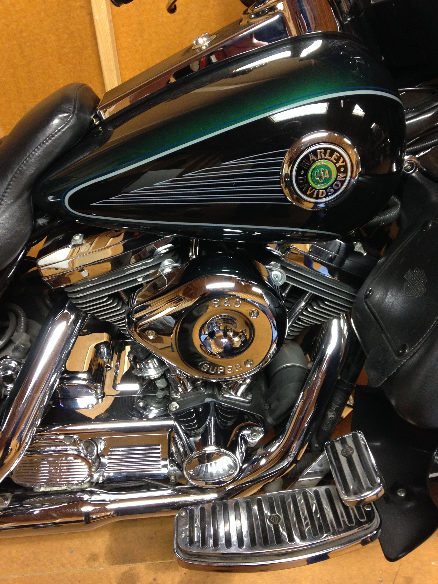

Old May 20, 2015 | 08:25 AM
  #74
flhchaz's Avatar
flhchaz
Joined: Sep 2011
Posts: 3,117
Likes: 1,728
From: In The Woods, PA
this is the Ultra I've been working on
Originally Posted by 92Fatty
Is the blue one in your avatar the 97? So are you running it in dual or single fire mode?
Yep the blue one is the '97, I've had it since 3/99. I'm running dual fire on both.
