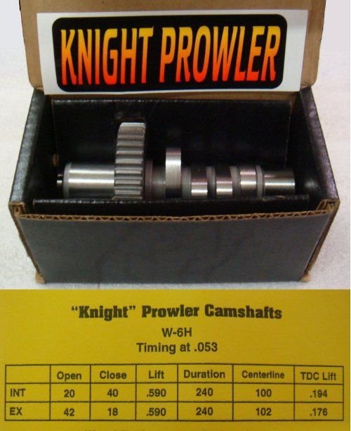

Stock - 212/202 108 lsa, overlap (9)
EV27 - Int 20/36 - Exh 44/16 - Duration 236/240 - LSA 101 - overlap 36
The Woods 6 is
Woods 6 240/240, 101 lsa, overlap 38 degrees.
I think he meant the Woods 6H, like a EV27 on steroids.
W6H - Int 20/40 - Exh 42/18 - Duration 240/240 but with a .590 lift.
More lift will lower power down - and with his ported heads add fill, I would have thought. Recommended for 88ci to 95ci.
The Headquarters HQ-0029 Rumble Plus would be another interesting contender in that area.
Int 20/36 Exh 51/19 - Duration 236/250 - lift .580"/.500"
They actually recommend their HQ-0028 for strokers with higher compression but it has really late intake closing again, and I don't know why. I would agree with you all the way on keeping the power lower down, Joe_G. The HQ cams aren't so well know but the asymmetric theory looks sound (The idea being exhaust gases only take up about 70% of what intake mix does).
