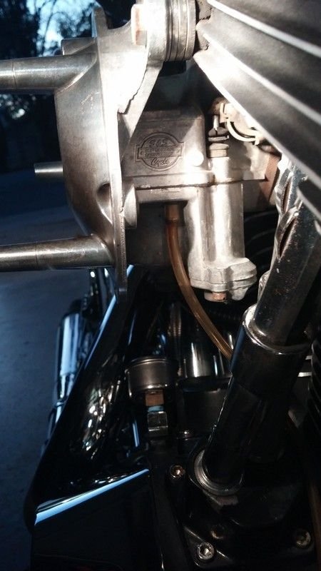

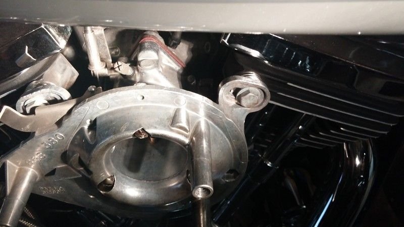

I checked and the only vent line I have comes out the bottom of my engine. Here's a pic of my carb/heads were the crossover tube would be if it was a head breather, am I correct?
And the only tube/hose coming out the carb, the bowl overflow I assume.
Old Nov 5, 2015 | 07:49 PM
texashillcountry's Avatar
texashillcountry
Dirt don't hurt
Posts: 21,066
Likes: 4,568
From: Haslet Texas
Correct on both counts.
