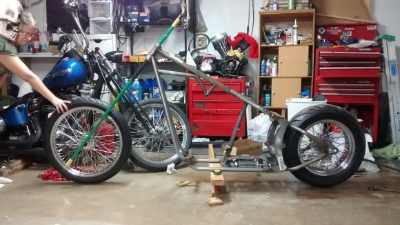

Originally Posted by Tee⋁14581553
How many over are the tubes?
For the life of me, I'm okay with math, I cannot figure how you got the motor and frame square with such a long front end. Everything looks level and proper. The neck ain't that far up, the rake looks about stock. How? Spill it, please.
Good paint too,
Tom
Like this Tee
Old Nov 17, 2015 | 08:12 AM
graultytc88's Avatar
graultytc88
Joined: Jan 2008
Posts: 359
Likes: 21
From: Midland Tx.
Originally Posted by Schex3x
Like this Tee
Sorry, didn't understand the question! I love simple, and this is the simplest way I could figure to measure the fork length. block up the frame where you want it, have the front wheel and measure! Most the time the fork seller provides the dimension from axle to bottom of triple tree.
