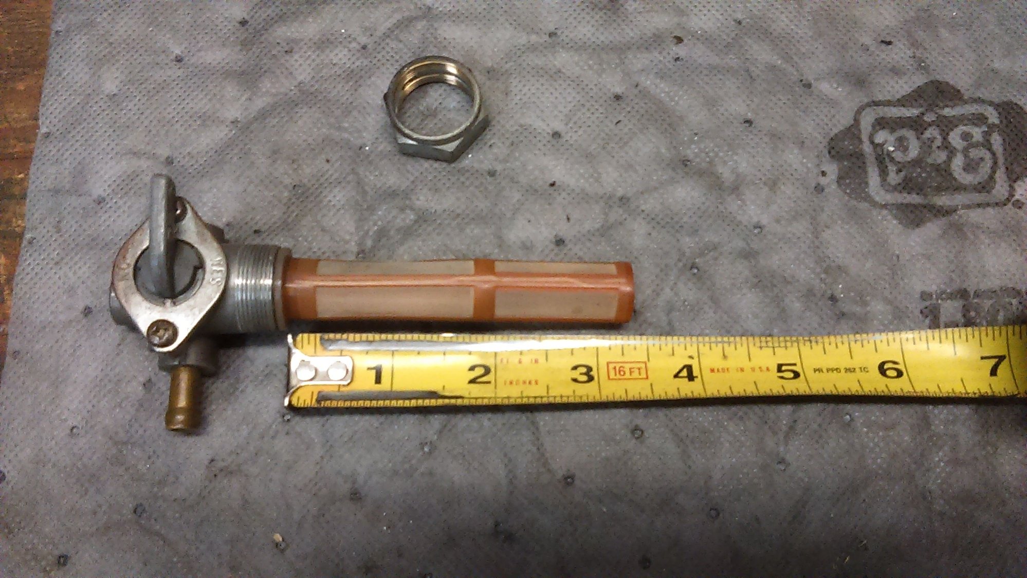

THC, I took this picture for you comparing the original tube adn the new longer tube. I actually cut 1/2" off of the new tube,. That should be plenty of reserve. The original tube is still attached in the picture and is about 1" long. The new on is around 2".
Now that's a hell of a difference!!!!!!!!!!
I wonder why they bother with the short tube??

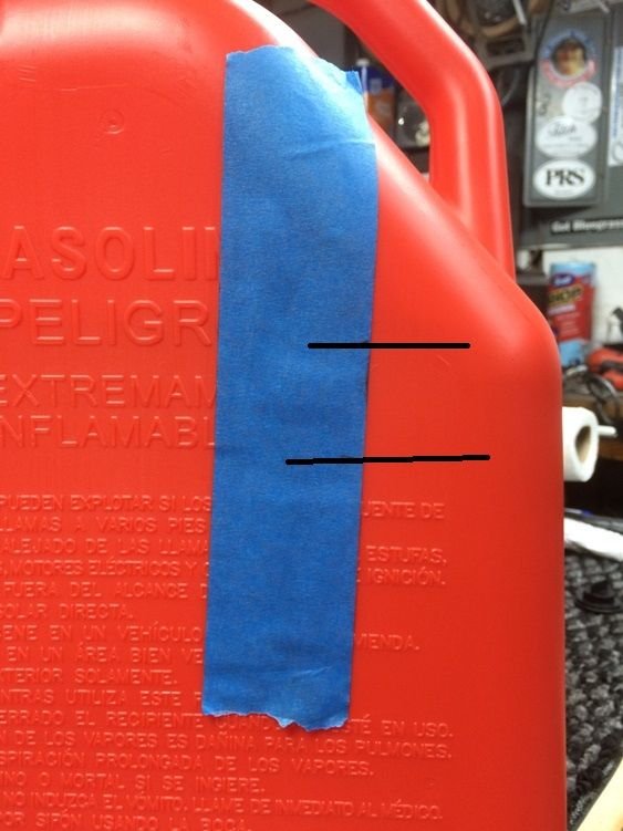

Here is the difference between reserve and empty now. Before, it measures 1/2" on my 5 gallon can. Now, it measures 1 1/4" which is just shy of 1 gallon. This should give me a 30 mile reserve.
