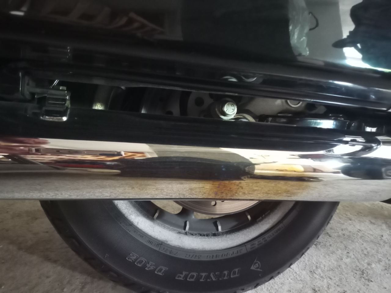

Hi, this is the right exaust of my 2003 Electra with CV carburetor. I have a misfire only when I start the bike. Someone know why? How to fix? Any help will be appreciated

The ten year plus reply above your post is a good place to start..
backfire causes
1) fouled plugs (most common)
2) bad spark plug
3) bad spark plug wires
4) bad coil
5) bad ignition module
6) dead battery combined with a pooched charging system
7) bad gas (water or just old)
8) engine timing
9) electrical wire short
