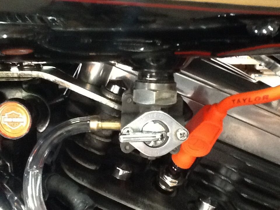

Off position, long end down for ON up for RES?
Old Jun 4, 2016 | 02:00 PM
Tony_N's Avatar
Tony_N
Joined: Nov 2013
Posts: 1,216
Likes: 286
From: Buford, GA
That's correct, down is on, up is reserve.

To get around the whole vacuum petcock thing:
"Turn the pet **** off, loosen the nut holding the petcock to the tank just enough to turn the pet **** 180 degrees then tighten back up. Next remove the screws holding the back of the vacuum thing to the petcock. Reverse the spring and diagram. Reassemble. Loosen nut and turn petcock back to original position.
Next time you have the tank or carb off, remove the T vacuum line and run a vacuum line from the carb to the voes"
http://crapmods.com/phpBB3/viewtopic.php?f=16&t=8954
I also think the petcock does not need vacuum to work on reserve? But can't confirm. YD
