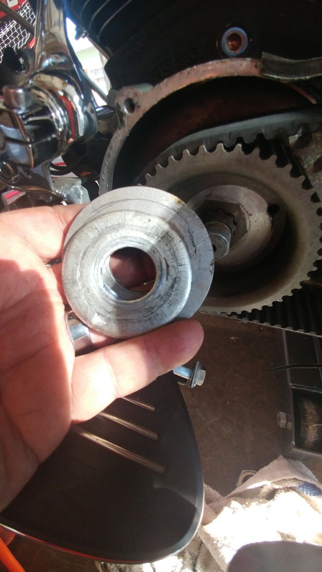

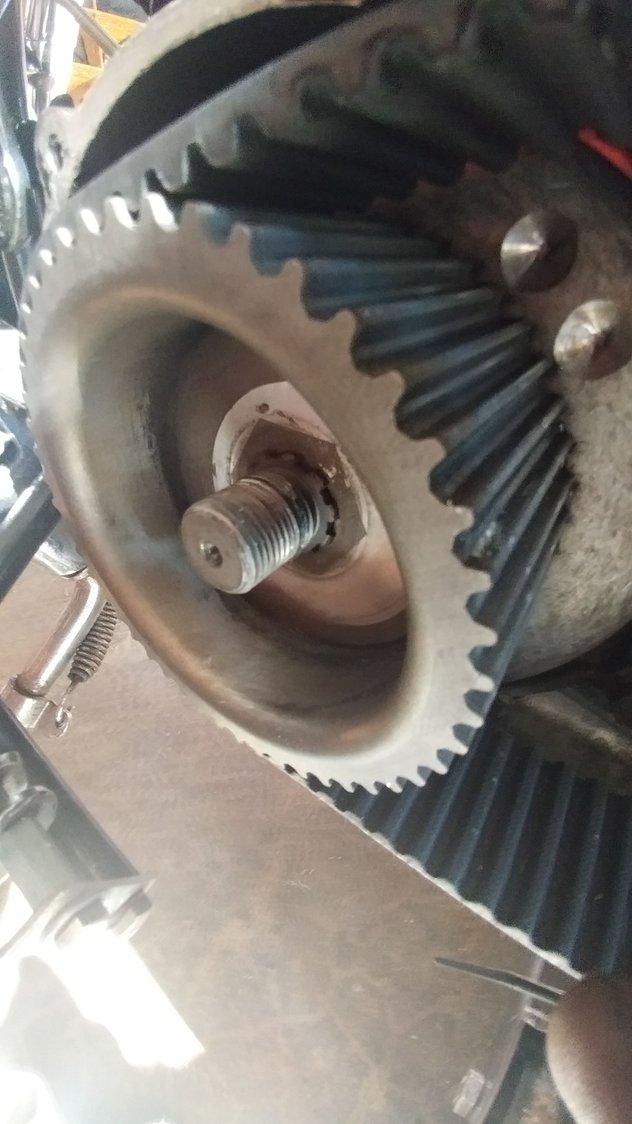

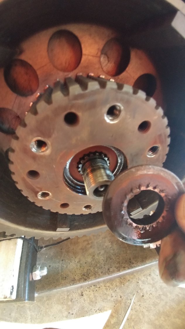

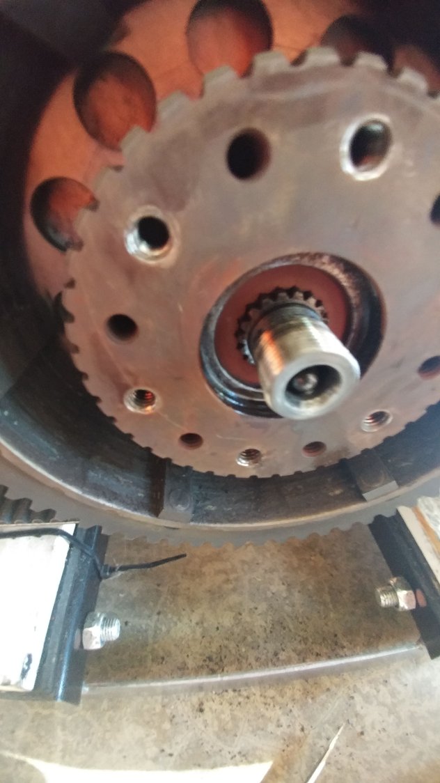

Ok so I was able to speak to a tech at BDL and he was very helpful. Told him my problem and that I have some play in the rear hub. He said there should be no play and to pull it and see if there was red locktight on the spline and hub, if not that's a problem. Well there wasn't and adding to it the splines stick out past the hub, not good (see pics). Front hub is the same but there's a spacer/shim and washer that takes care of that (see pics). I made up a couple steel spacers/shims to go on over the clutch hub but don't want to put it back together till I speak with BDL again. I
have the right belt for my setup which is 72 tooth rear 42 tooth front so a 141 tooth 1 5/8 8 mm belt. I'm trying to get son video of everything uploaded to also show a intermittent noise coming from the rear hub and a few other trouble shooting things while I have it apart. Oh btw the splines on trans drive shaft look good and the inner hub looks ok but not completely sure yet as I have nothing to compare it to. I'm supposed to call tech back at BDL but haven't been able to get a hold of him yet. When I do ill post up more info.
