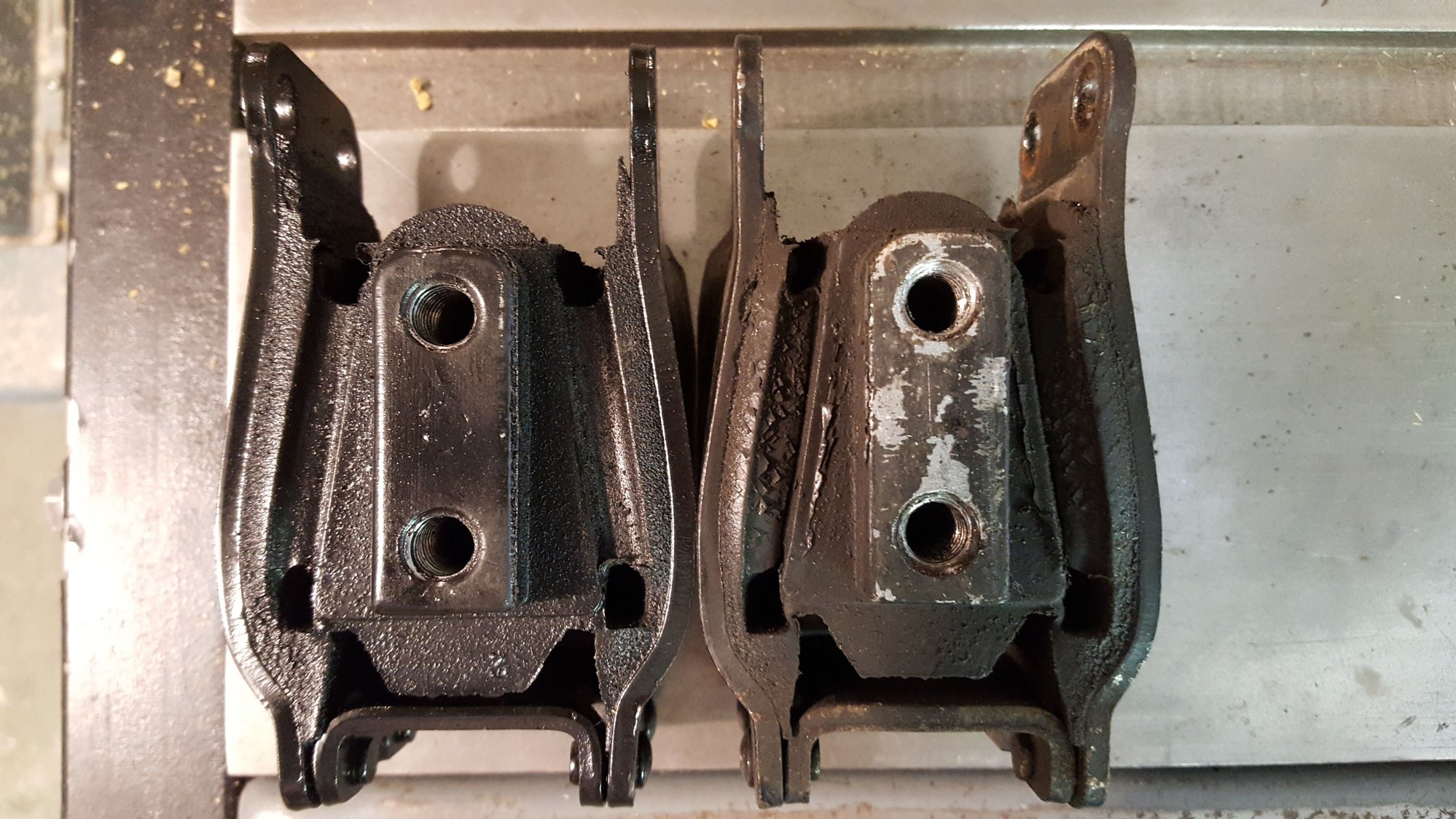

Rear motor mount gone. Front was probably shot too. I only got three years and 11k miles on them! Replaced them both.
Are there any better aftermarket alternatives?
My motor is solid mount so I wouldn't have the same issues as you. But throughout my life I've never bought any other suspension parts other than Moog. not sure if they make anything for Harley's but maybe you should take a look.. China lasts like a year if your lucky.
