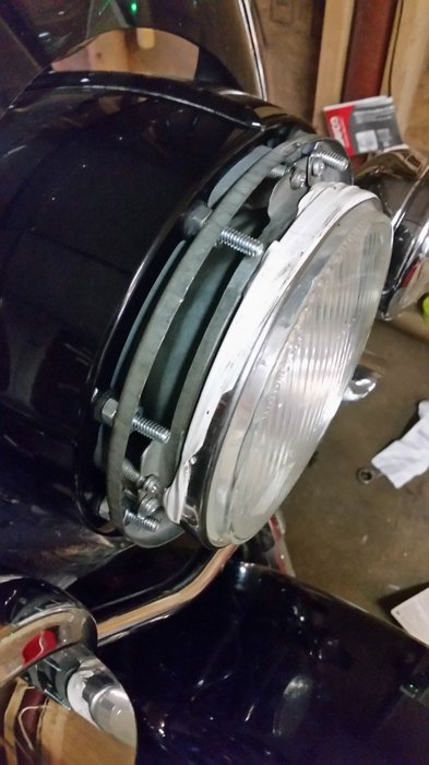

So I had probs with the motor mounts vibrating the well nuts that mount the headlight off. So I am trying a different approach. I took 8 1/4"x1 1/4" and threaded them through rubber grommets that are in place of the well nuts. Then used nuts to hold the bolts down and another sets of nuts to hold the headlight assembly in place. So think this may work? Btw I haven't figured how I'm going to fill the space between the light assembly and the nacelle.
Its a different approach but figured it wouldn't hurt to try out. Otherwise I can just go get well nuts at Home Depot for .59 and put it back like factory.
