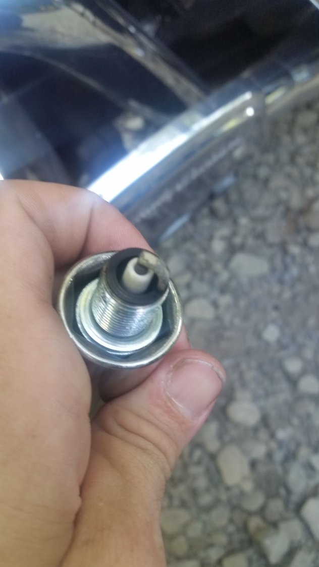

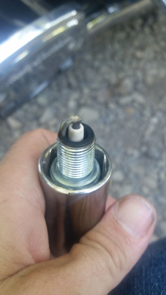

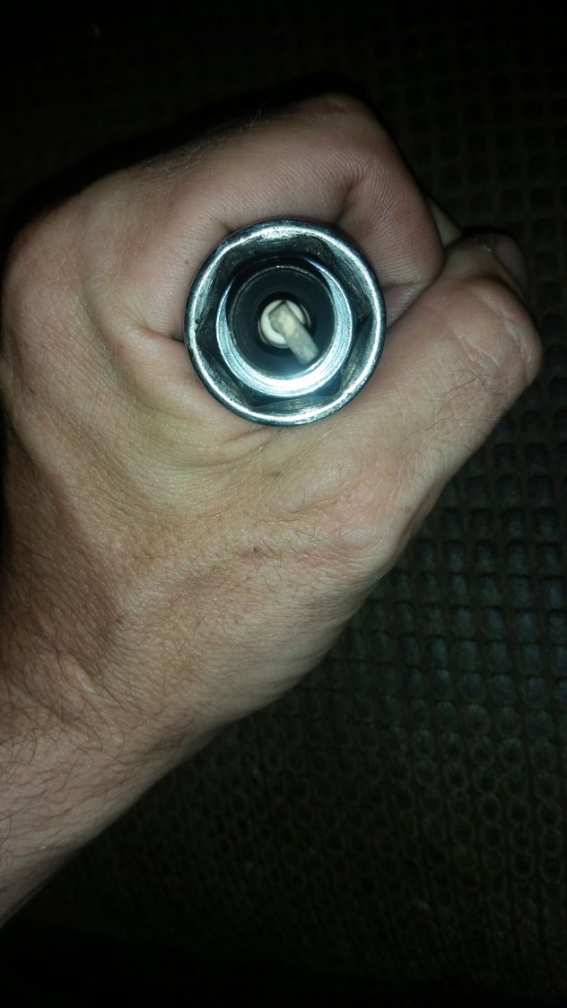

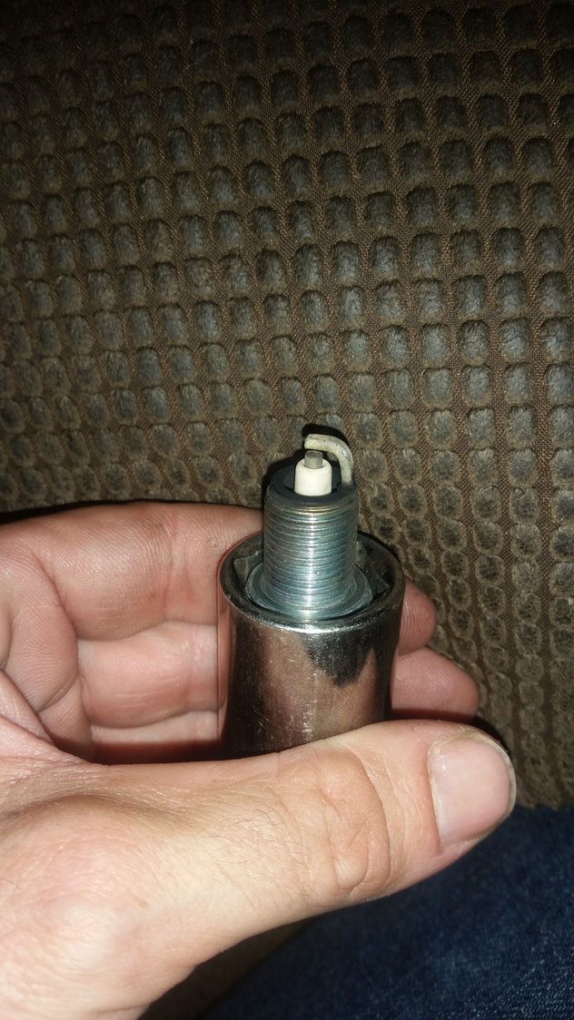

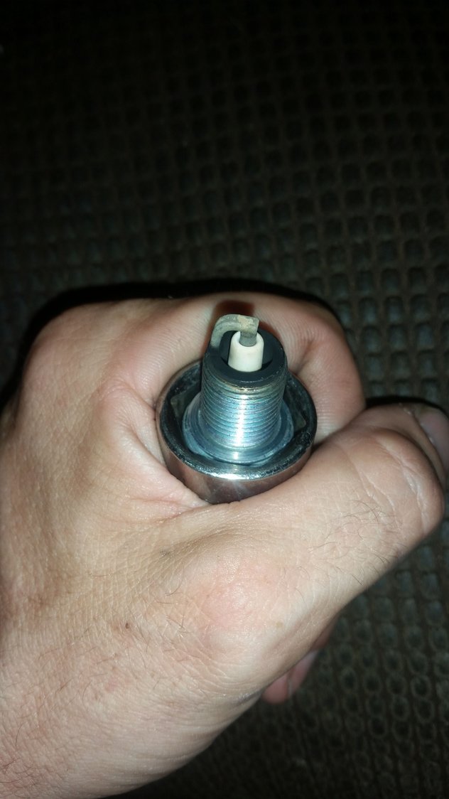

Well after the new jet someone needed to put miles on it so I volunteered myself I know I know but I needed to run it. I put 150 miles on it and here's pics of new plugs. Still smells rich at idle I have great throttle response my low mid and high is spot on no hiccups or cough out of carb. Still pops on deceleration. But what baffles me is at idle it still smells rich. No more black smoke I can see anyways

Looks like my burn is good. To me it looks a little lean but a lot better then the really dark I had before

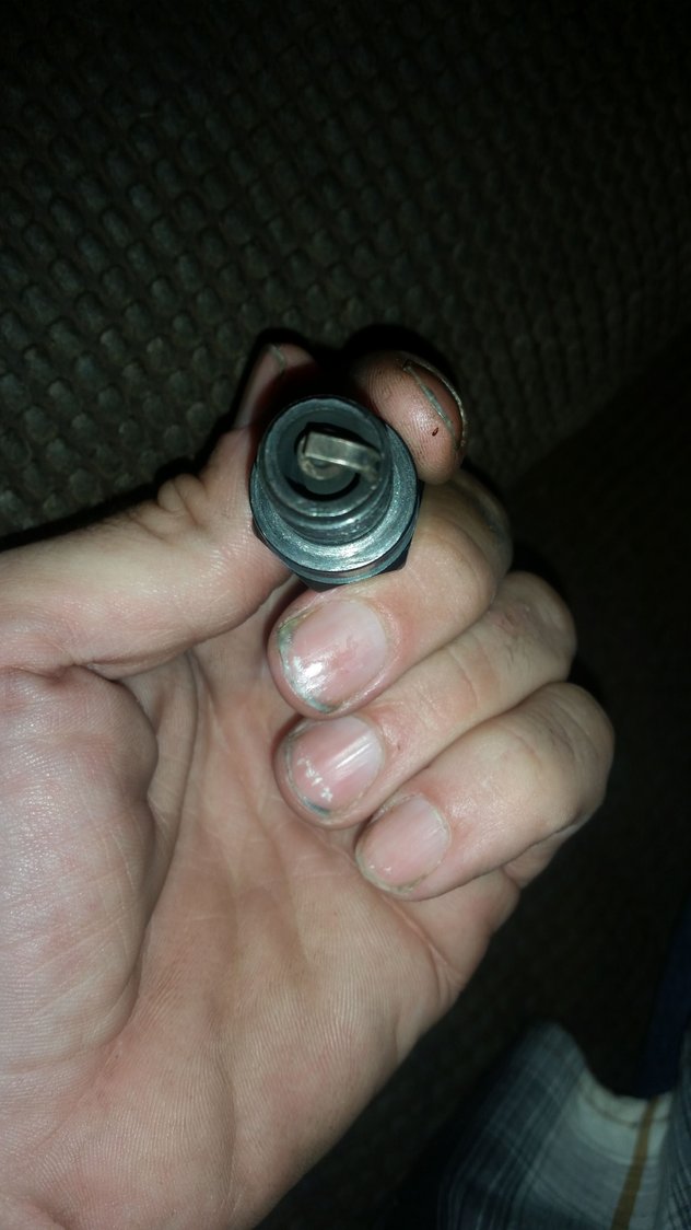

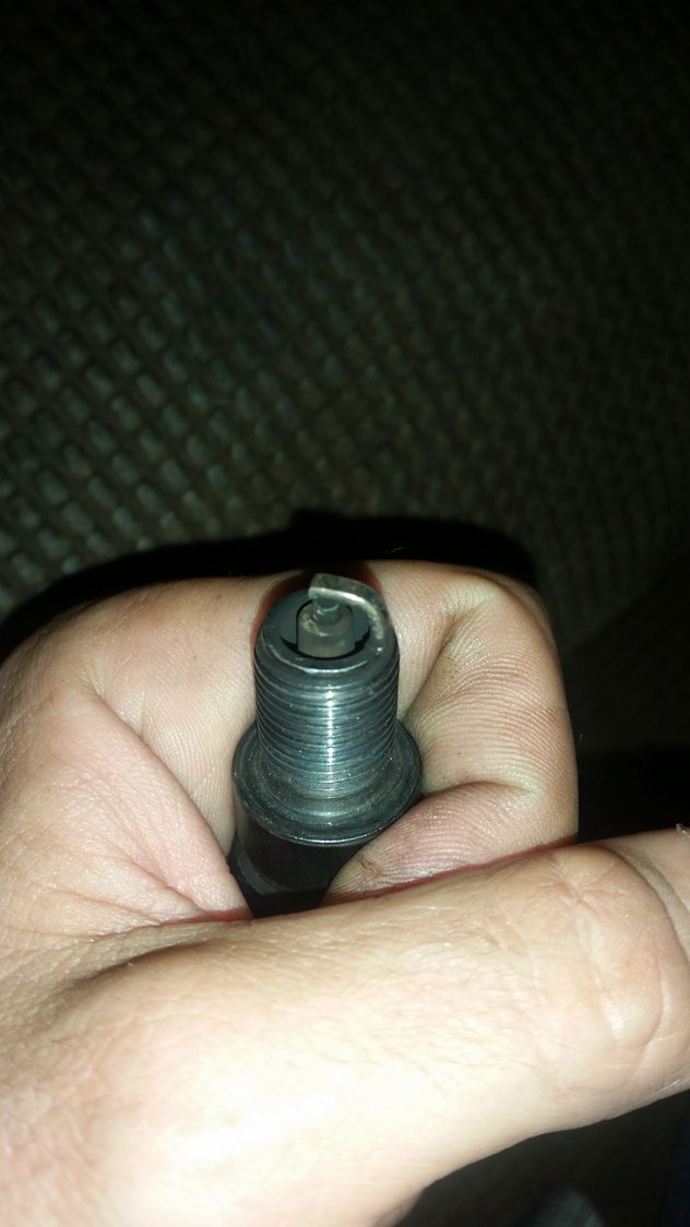

This is what I was dealing with before. I did get it a little lighter then this but it was still pretty dark. I changed plugs a lot while messing with the carb. But I'm still dumb founded by the rich smell at idle.

Your rich smell at idle may be normal for anything with a carb. If your experience is almost exclusively with modern fuel injection, a properly running carbed vehicle will smell different to you.
