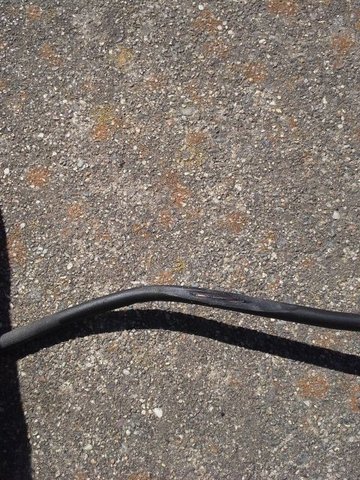

Success...local dealer had one for $130. Found a rub where it was shorting to the frame.

That will do it...
