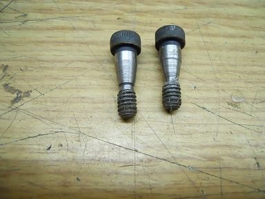

I've never had a lifter block come loose enough to move. Personally I've never worried that the screw holes for the blocks might be drilled wrong. Think about it, they don't drill and tap those by hand you know so I always use the block alignment screws just because. After all they're cheap enough but because I'm cheaper the they are I made my own out of a couple of shoulder bolts and they work fine.
Finally, if you're going to use thread locker on the block screws make sure you clean out the holes with carb or brake cleaner and blow them out well. The thread locker won't work if there's oil in the threads.
