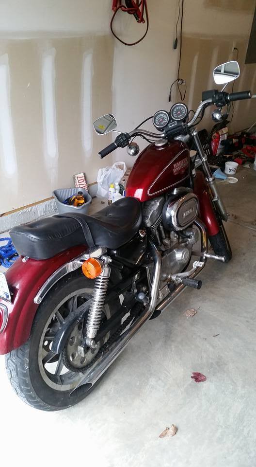

I just got this '89 sportster in November, 26k miles. It's my first Harley. I've got probably 75 miles on it so far.
The gaskets at the base of both heads are leaking pretty bad, so I'm going to replace those. I assume there's plenty to check and fix along the way, but I might need some help building a to-do list.

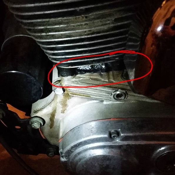

Post a picture of the leak at the heads. I have a suspicion about that but if I say it now I will sound like a jackass.

Oil leak image attached. I've since globbed some permatex gray silicone on there to try and get it to stop. I really wanted a temporary solution so I could drive it a bit and try to figure out if anything else is wrong. The silicone did not hold up but it may have slowed it down some. I think the rear cylinder is also leaking from the back side of that same gasket. It's not as quick as the front though.

That's the base basket leaking, not the head gasket. The base basket goes between the cylinder jugs and engine case. That's a bit more work than changing a head gasket but it isn't terrible. The straight pipes can cause a lean running condition unless the carburetor has been rejetted and adjusted. Running too lean can damage the engine.
They make a kit to convert from chain to belt drive. The kit has front and rear sprockets, the belt, and upper and lower belt guards. It's pretty easy to do.
I have circled the area that I think you are referring to that is leaking, if that is it, then that's the aforementioned base gasket.

I've heard some people have had luck with cleaning the base gasket leak thoroughly then laying super glue along the base. Can't hurt to try, but bottom line is that those leaks aren't fatal as long as you maintain the correct oil level as you ride.

If there is syntheshit oil in the engine you could try changing it with real engine oil(conventional) ,clean that area up and see if it slows back at all or stops leaking all together....

I had a pretty good amount of silicone on there but it still didn't hold up. I'll probably just replace that gasket. I'll hold off on the belt drive for now hah. I may want to clean up the chain and sprocket. I can take them off and soak them. The sprocket definitely has some life left in it if I can keep everything clean and lubed.
