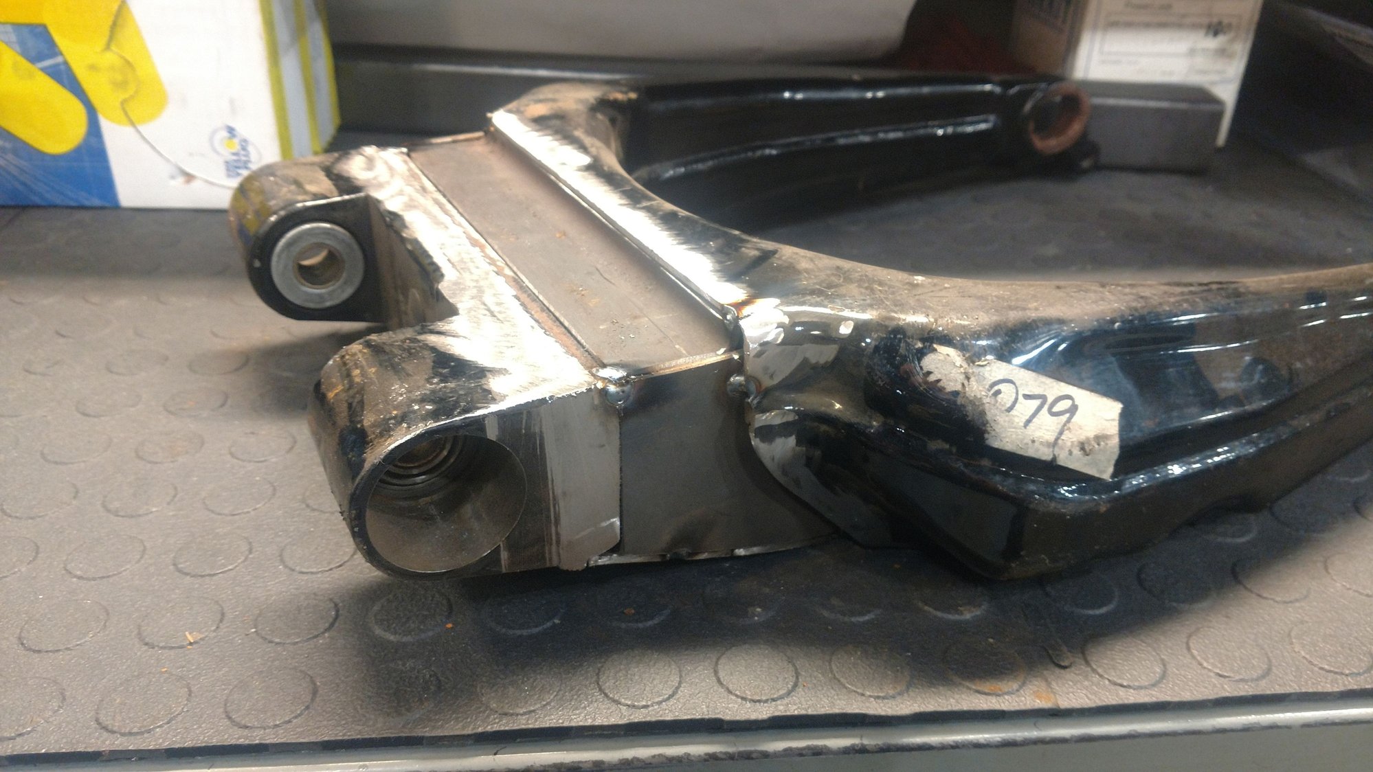

More mods, had to modify the new swing arm to fit the old frame. Just have to weld it up.
