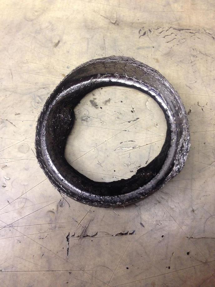

This is a good example of what I was talking about with the exhaust gaskets blocking the port, came across this repairing base gasket leaks on a bike last night.
