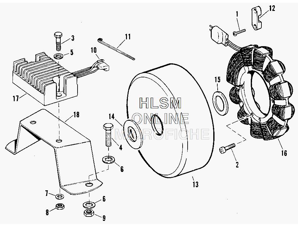

That gets to the part of this where my imagination is running away with me a bit.
Breaking this down into two sections (First, the comp side, then the clutch side):
On the compensator side, when I look at this diagram:
I see the #8 shim. My bike has three shims there. One thick, two that are thin.
Then I look at this diagram:
And wonder what Part #14 is supposed to be. The part number for #14:
Does not correspond to any of the part numbers for #8:
Which leads me to conclude that the thick spacer I have is my #14, and the thin ones are two #8's stacked together.
And in all of this, I can't find any diagram anywhere that shows a shim behind the clutch basket.
Which has me wondering if the shim that fell out (the one that I am all but certain was on the clutch side of things and which does not fit well on the shaft) was a hack that some prior owner or mechanic added for whatever reason.

#14 is a snap ring for the clutch hub behind the clutch bearing #16, if that .010 shim came off the clutch anywhere, it doesn't belong there.
My guess is that shim was probably stuck to the compensator when it was removed.
Is that shim the same od and id as the two .010" shims?
Check sprocket alignment.
Old Mar 20, 2017 | 02:48 PM
0maha's Avatar
0maha
Joined: Nov 2012
Posts: 6,555
Likes: 4,805
From: Omaha
This gets confusing. I was referring to the #14 in the charging system diagram, not the #14 in the clutch diagram.
That's what I was thinking. It just seems "wrong".
There were two shims stuck to the compensator. This isn't one of those. I'll double check the dimensions tonight, but at first glance, the mystery shim is a different size.
Definitely.
