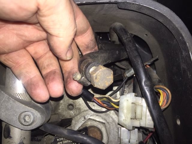

Like this clever piece of engineering.

The 'old bolt in the hose' trick.... Nice.
When the apes were added they don't have provision for the anti-dive system, as the OEM bars are used as the air storage 'tank'. So that is how they 'capped off' the system.
You probably should put a set of Progressive fork springs on the to-do list. I know I'm going to eliminate the anti-dive on my 93 FLHS, and go with new springs. But that'll be this fall/winter's project.
