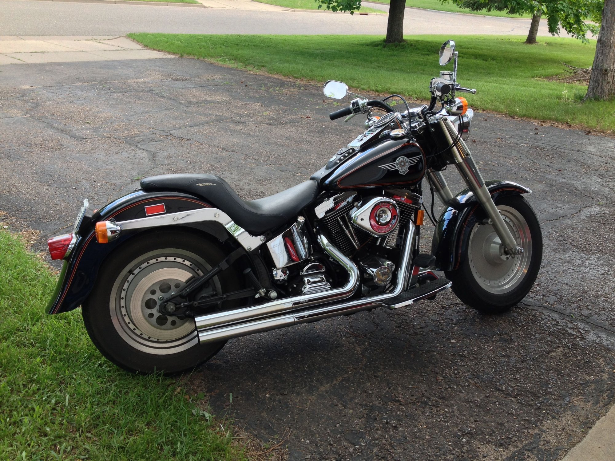

So I thought I would finally start a thread to document some of my progress. My 1994 Fatboy had the luxury of getting hit last fall in a parking lot. After a long back and forth with the insurance company I got to keep my bike. I will upload photos later.

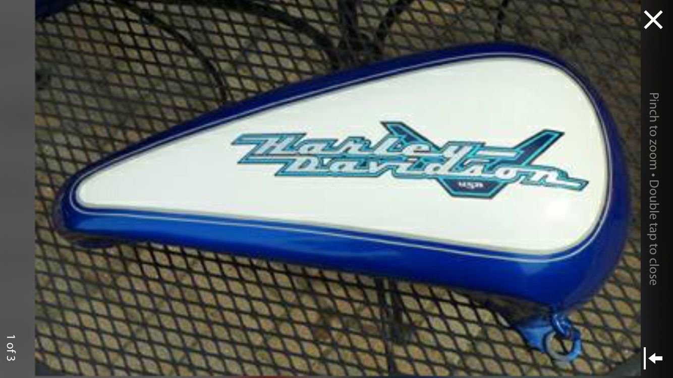

My original idea was to change the color on the bike from black to a grey (Grigio Telesto) and go with stretched tanks. After I purchased the stretched tanks I decided I did not like the look as much as I thought I would have. I ended up finding a full set of tins for a pretty good deal and were freshly painted.

I added some pictures. It is original black. Same as the Terminator bike haha. The Todd's bars are internally wired. I used some shoe string with a nut at the end on it to assist in pulling the wires through. I have done it a couple times now because I wanted to add wire loom to help prevent wires from rubbing on the angles of the bars. Was WAAY easier pulling them through with the wire loom.

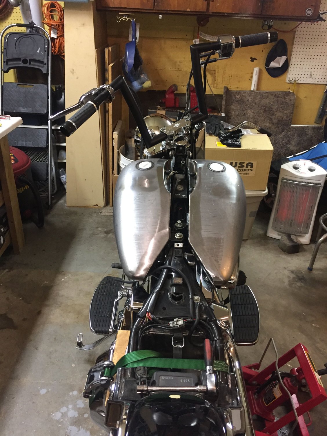

Finished up with wiring the handlebars last night and also installed the riser bushings.

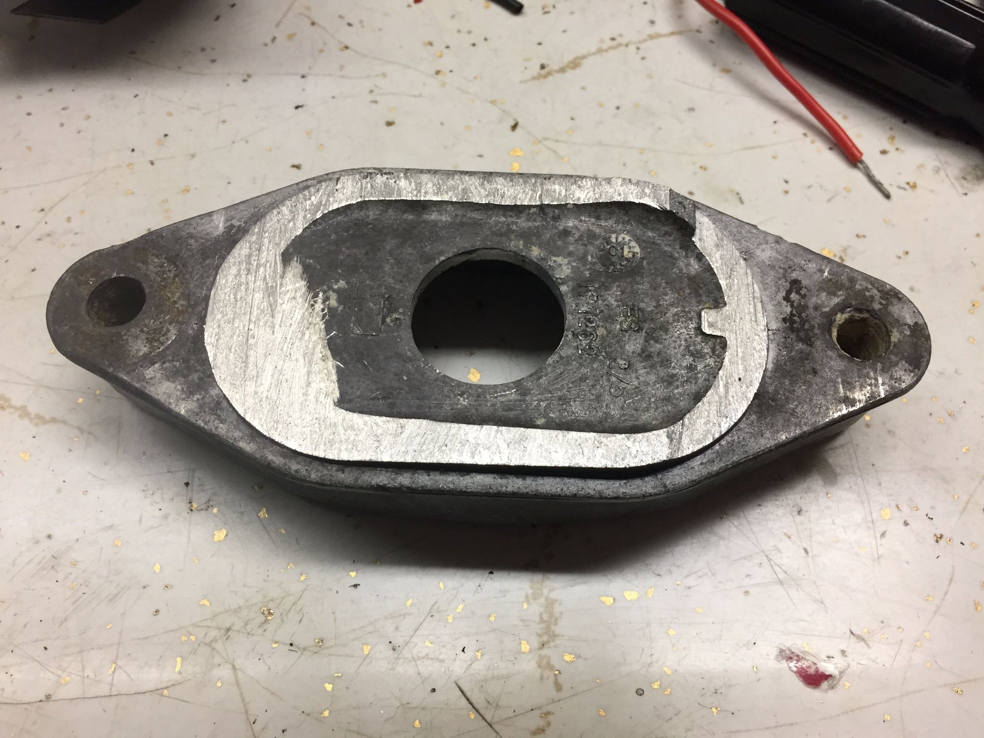

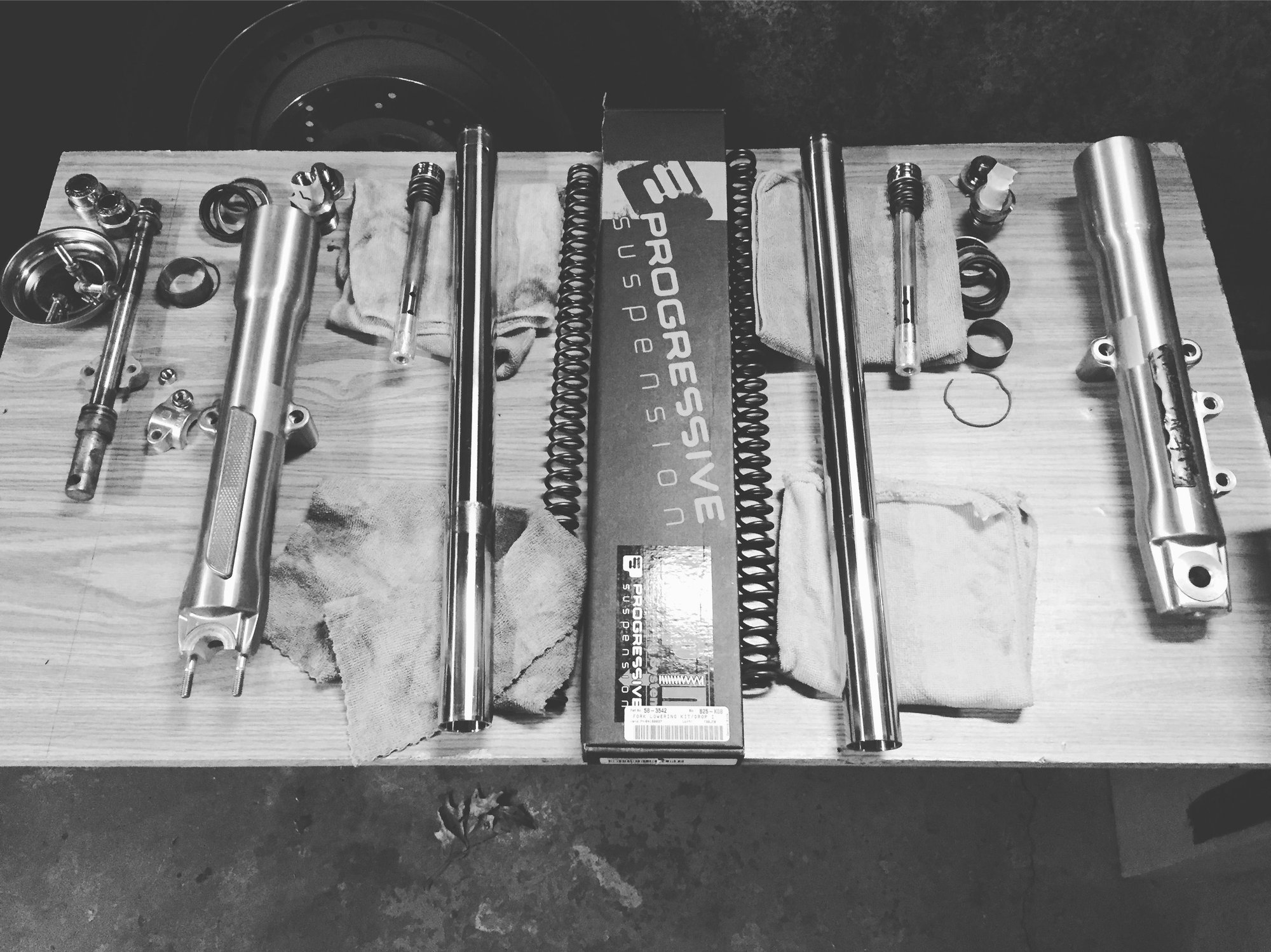

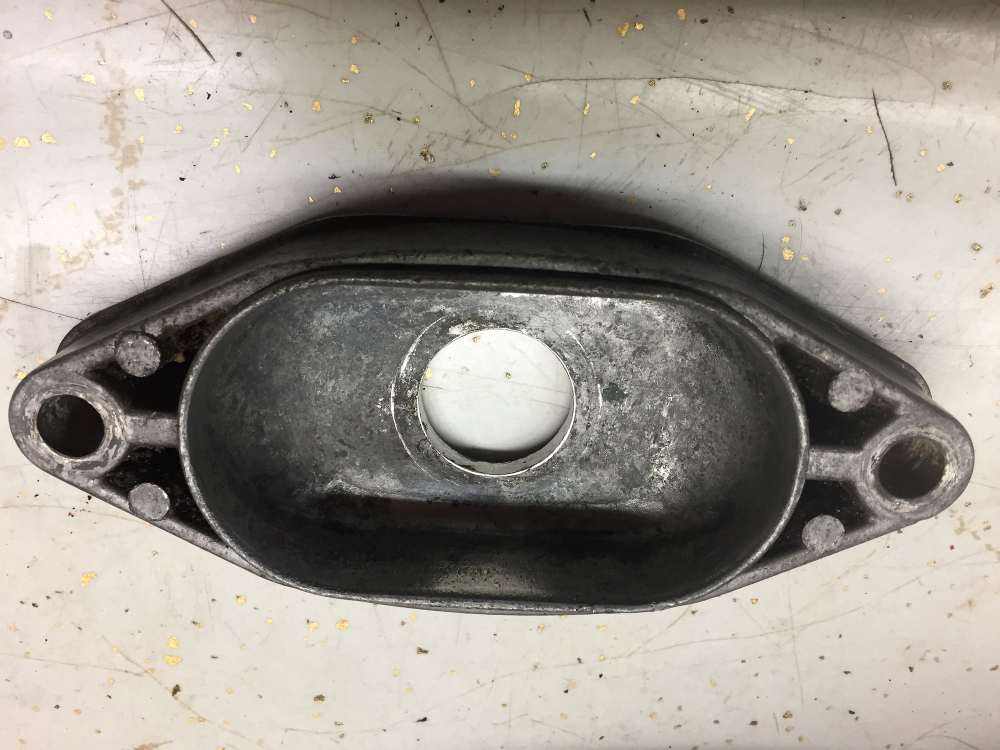

Figured I would also share a little tool I made for helping compress the springs to get the top bolt back on. I rummaged around the scrap pile and found an old Vw dog bone mount (mount where the engine and trans meet) and only slightly modified it. With the help of a friend it was super easy to compress the spring on and get the threads started
Looks like a cool set up.
I just use a palm ratchet myself.

Thanks, It worked out pretty well. I didn't have my vice attached to my work bench yet so I just tightened the tube back in the triple tree. Was easier than I thought it was going to be.

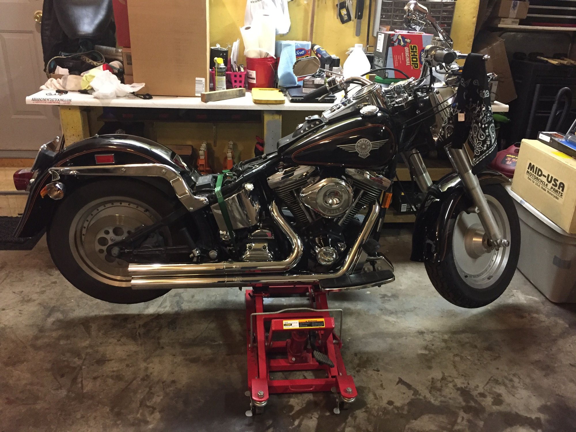

Last week I got my tire mounted and new wheel bearings Front and rear. Got the rest of my parts ordered up today with plans of hopefully having everything back together this weekend.
