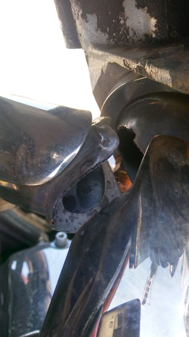

This sux. Out for a ride and this happens. "Y" exhaust tube coming off the rear broke.
Immediate question is I can run it 30 miles or so home, or do i need a trailer?

I'd trailer it.

Trailer is better but 30mi aint much. It's gonna be loud. Mine kinda split not as bad as yours but I made it home from 20mi out.
It's been sorta a common thing on our bikes.
"Well honey it's just better to replace it with a new pipe."
Can I say 2-1 D@D fatcat

Wow...that looks bad....will duct tape help?

I burned an exhaust valve with a broken Y pipe and ended up replacing the heads with a set of take offs.....so only if you can wrap / patch up that hole IMO.

Well, the deed is done.
This happened about 10 miles north of Missouri Valley, Iowa. Rode it into town and stopped at McDonalds. That's when I saw what the problem was.
Kind of satisfying, actually. As we were limping into Missouri Valley, I was trying to think of what it could be, and that was my best guess. So hurrah for good guesses.
Anyway, sat there and noodled on it. Called a buddy with a trailer (big time stock car guy back in the day). He wasn't home, but we talked through it and he figured it was either fine to run, or that the damage was already done so nothing left to lose.
So we ran it home. Slowly. Thought about pulling the wire off the rear plug, but somehow that seemed like the sort of idea that was too clever for it's own good, and would only cause more troubles.
Anyway, it ran surprisingly fine. Decel pops were out of this world. You learn quickly to completely avoid engine braking.
BTW, in hind sight, I should have seen this coming a few weeks ago. I started getting decel pops once in a while. Never had those before. Looking back, that's probably when the trouble started.
I'll pull the header off tonight after it cools. I figure I should also run a compression test to see what's what. We'll know more about the state of things by then, I hope.
So....................
Now what?
Assuming the motor isn't munged, I still need to sort out this exhaust, and fast. I've read guys say they get cracks at that location welded, but what about a complete break like that? I just got done spending all my money on home improvements. Really don't want to drop a bunch more money I don't have into the bike.
Think that's weldable?

I would guess a welder may charge more than a stock set of take-offs would cost. They're had to be some on Craigslist. Im sure somebody has some in their stash.
Time is not on your side now with your trip next week.

An automotive custom muffler shop is the cheapest way to go. They will charge very little for a repair like that.

If the exhaust valves move up and down freely (normally) tomorrow morning (as in the bike starts OK,) then you didn't hurt anything.
