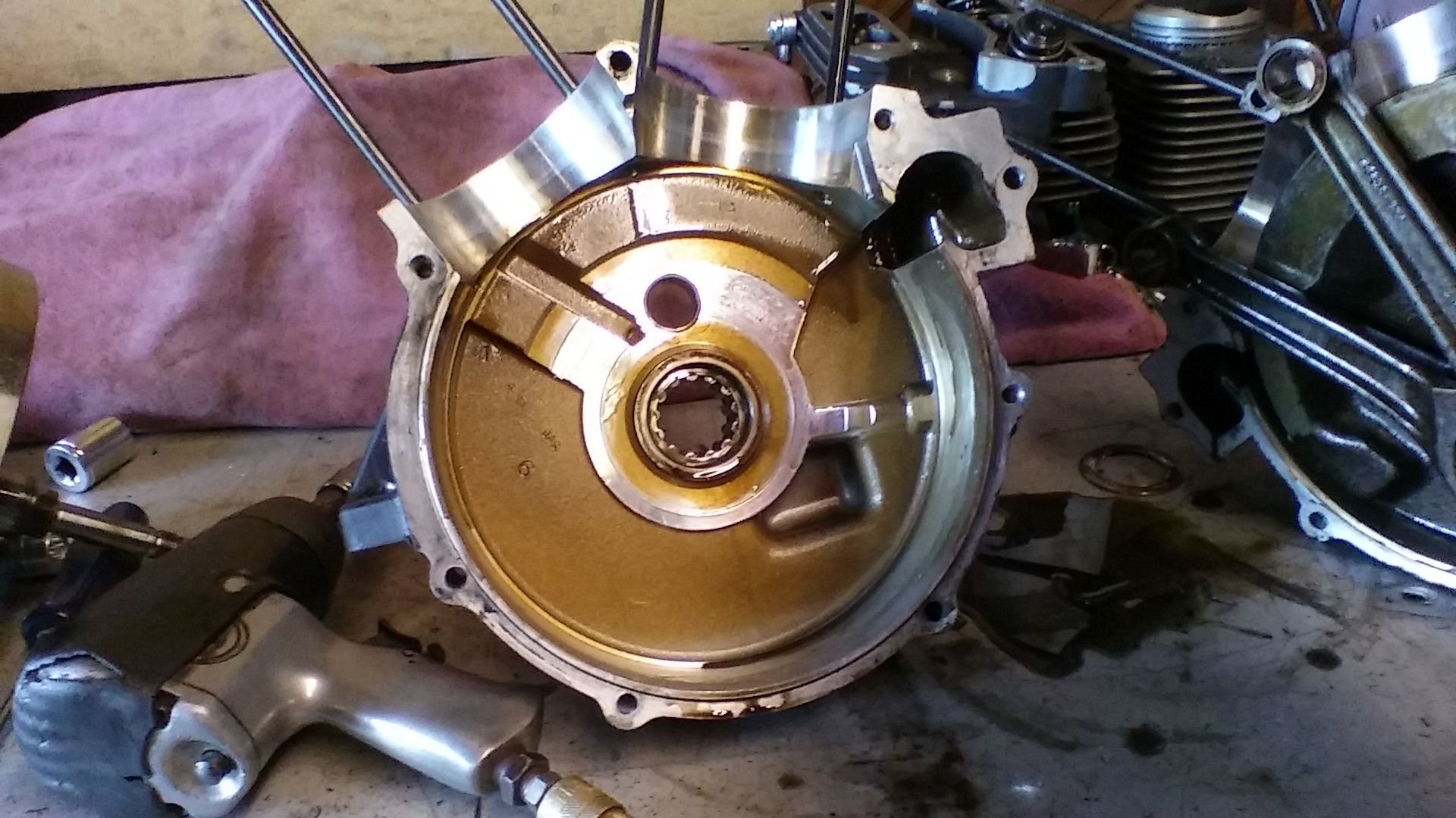

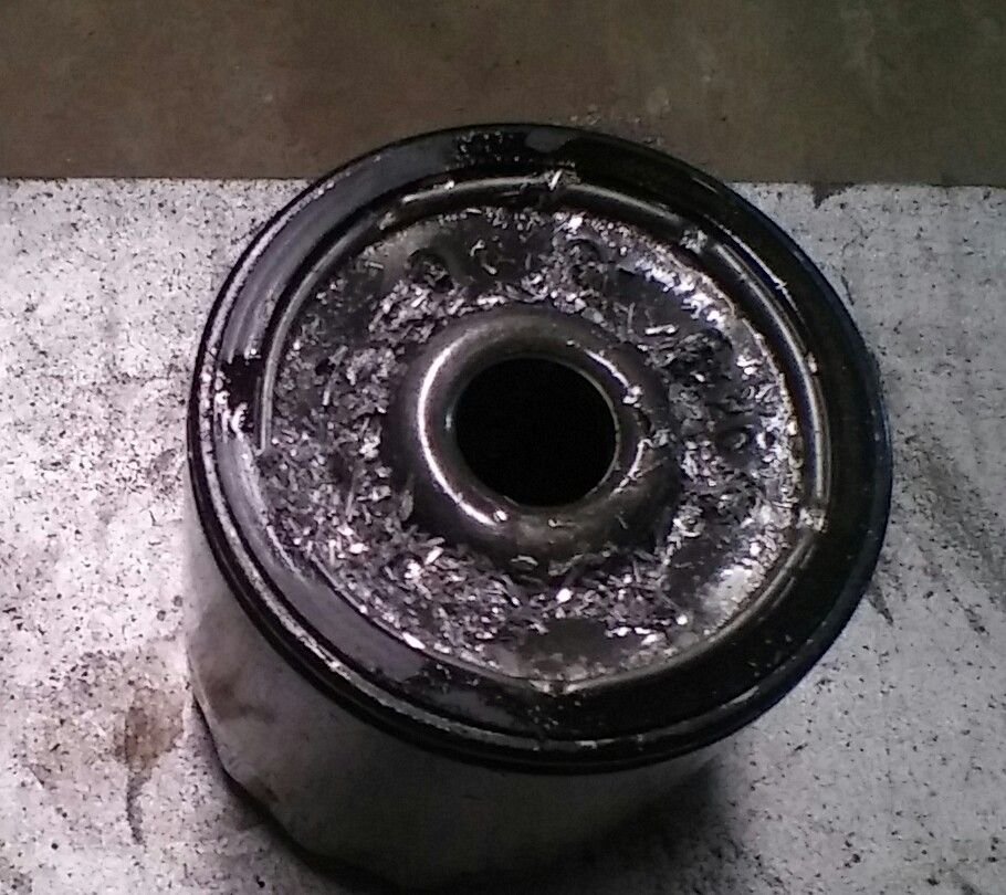

It has to do with the oil port in the crank pin. Also has to do with hard riding, the oem crank pin doesn't like getting the **** beat out of it. I know cause same happened to mine but with 97/96 tq/hp...
Flush all your oil lines and blow out all oiling ports... Also tear apart the oil pump..
Now is the perfect time for an S&S 96" Stroker.....
That's what I installed..... 115/109
AHH, yeah there has been some rough riding. AT this point I am unsure how repairable these cases would be. Now to show my ignorance, is the S&S 96" Stroker a complete new engine, or guts to repair this one? At this point I am unsure if I want to dump 4-7,000 in to a new motor. I would love to rebuild, if not my only other option is to try and find a good place for a good used motor. Thanks for any help

Trust me it's fixable..... Mine was worse than that. I will look for my pic's from last year to post later...
Cool!! I was afraid that since so much was shaved from the insides, that it would make the cases unusable. I look forward to seeing the pics..and Thanks so much, you do not know how much your response has encouraged me!

In your pics I really couldn't see damage to the case other than where the crank pin nut shaved the side of the case.... Took mine way down... Still usable. Take it to a local indy to press in a new crank. Get a professional opinion...

S&S sells stroker kits and complete motors. I suspect a complete motor will be cheaper, but if you want to keep your original motor number, I think that's fixable. It will take a bit of TIG welding, maybe a fabricated sleeve or two, boring, etc., but anything is fixable if you try hard enough and/or throw enough money at it. Also, there is an upper limit on how big of a stroker kit that HD cases can handle, and I don't remember if 96 is over that or not.

Like I said earlier, I didn't see any other damagedTill I zoomed in... You must have run that a lot before the case broke....Probably the best thing to do at this point is an S&S V111. Yea Sorry I didn't see it earlier..... That case is shot...

That is what I was afraid of!! I am unsure if I want to drop for an S&S right now. As this bottom end is toast, I may look into a used motor...but that is an iffy thing in itself, finding a decent one from a good source at a decent price. I would not know where to begin looking for one!
