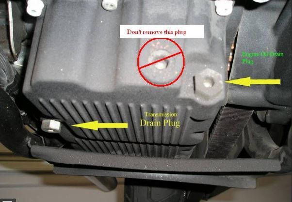

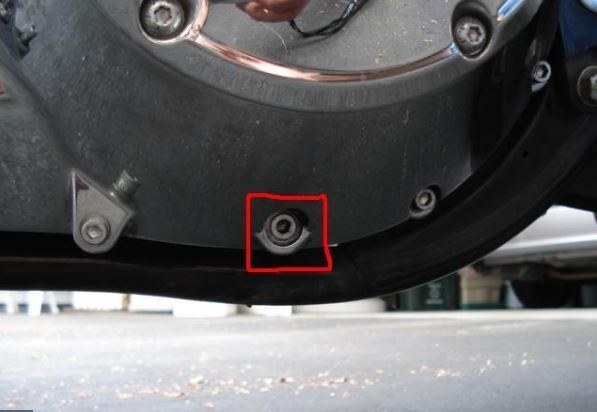

Some pics...

^^^^ I believe these pics are of a twin cam. The evo drain plugs look like a bolt. You should stop by a dealer and get a Factory Service Manual if you plan on doing your own maintenence

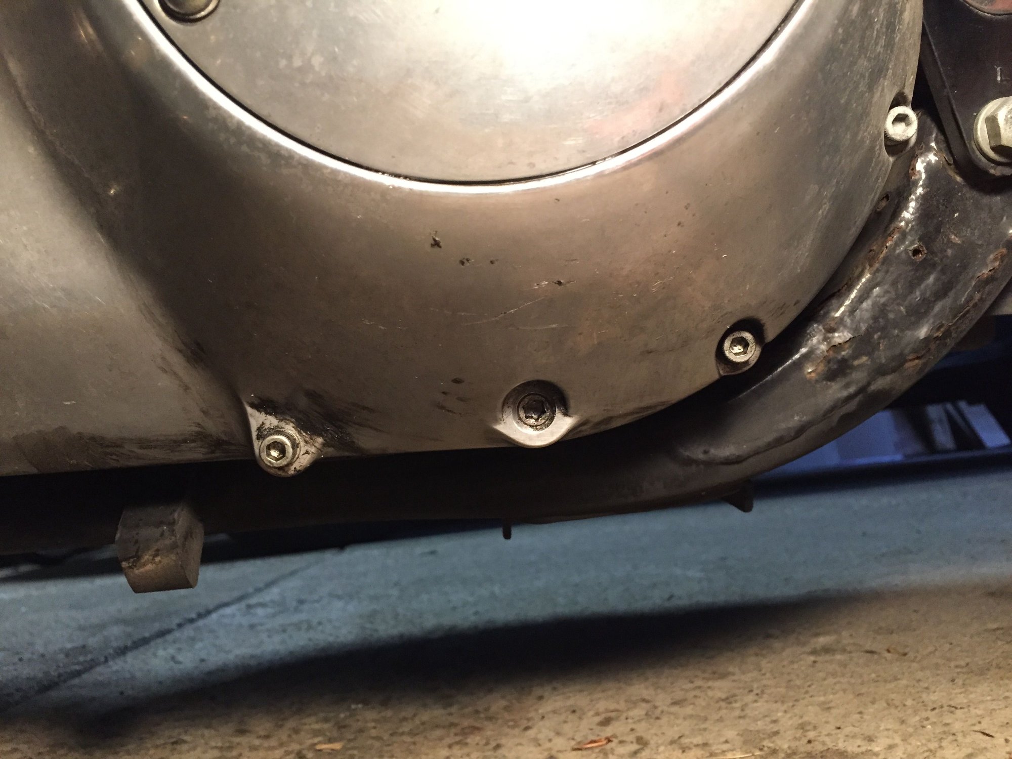

OK, I found them. The primary is that T40 torx
right in the middle, correct?
It just takes me awhile.......but I get it. Thanks for the help.
correct

The photos Tired posted are correct for your '95 FLHT ... be careful installing the T40 on the primary ... it is easy to screw it in too far, (ask me how I know) ... it is a tapered pipe thread ...
