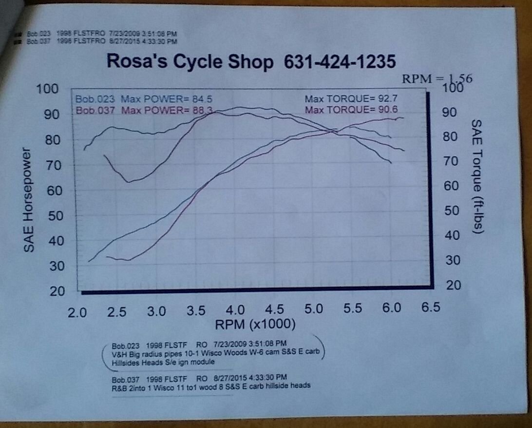

Originally Posted by aces&8s
9.8-1 compression will keep you from pinging with todays **** gas. 10-1 weisco pistons, .030 head gasket, W6 cam, S&S E carb will probably easily smoke the 88b.
If you want an engine to last forever and out run 99% of the bikes on the road drop a S&S 111 in it.
This is the "BEST" build for a reliable , high gas mileage, and power band in an Evo..... Period..... 93 tq and 84.5 hp. felt good too...

Well it looks like I'm halfway there. I need wiseco pistons, a w6, and I have already pmd Scott at hillside about looking at my heads.
those are some impressive numbers from an 80ci motor. Looks like it's gonna be time to start shopping around.
