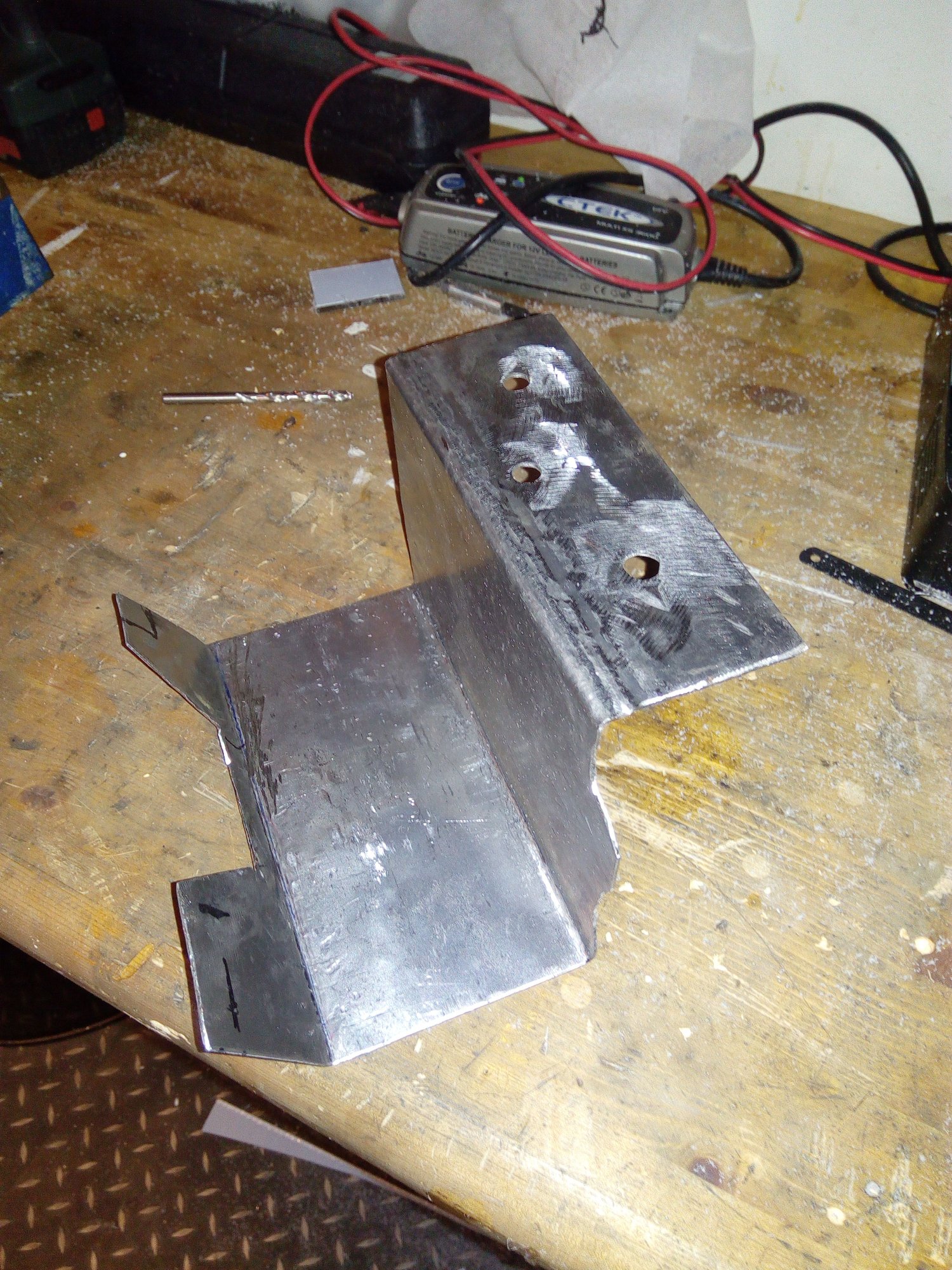

Any pic or info on relocating the battery? Thinking about adding newer bags to my 88 FLHTC.
Hear you got some pics of the battery tray. I welded 2 nuts underneat it for mounting and the 3 one in the center for the rubber strap. I don't remember the dimensions, but I only use a Softail battery and the bottom of the tray is not wider than the battery. Where you see the black marks I used screws for car body.
Underneat from rear.

Thanks for the pics. Really helps.

Nice work on the battery tray and really cool bike.
