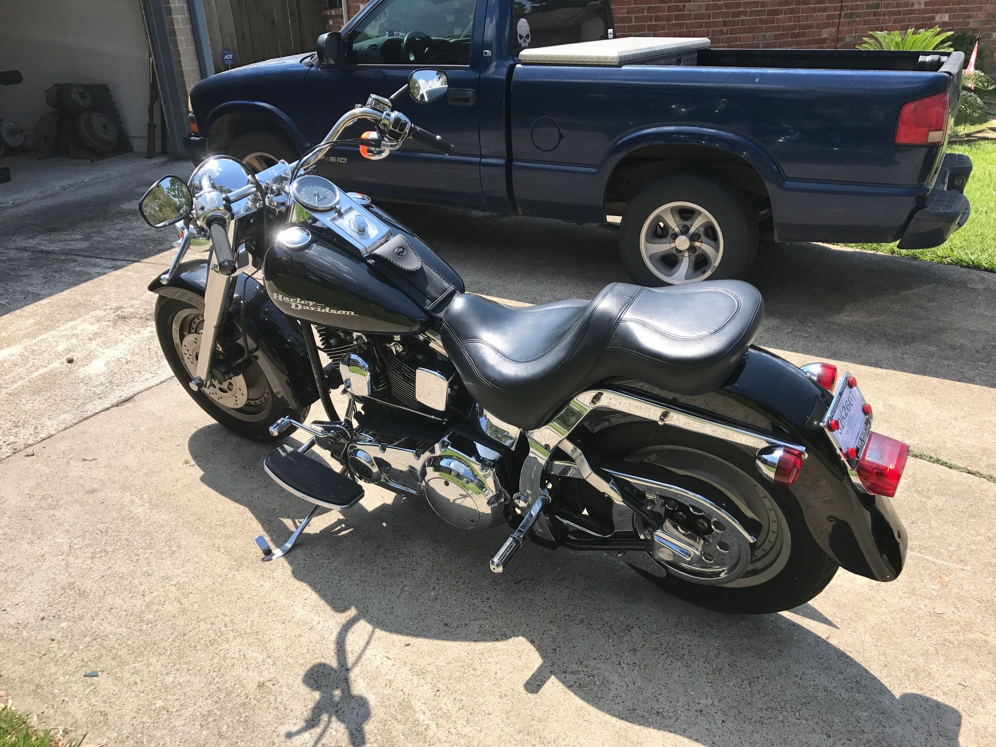

Ordered rebuild kit! I'll start simple. Pretty sure it could use it lol. Was real dirty when I acquired it but now...
Not a fan of the seat...
