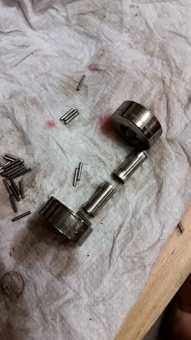

Dammit, need lifters. The bike had Jims lifters in there but 2 or 4 of them have notchy bearings when I roll them in my hands.
Any suggestions?

Non-servicable my ***:
Look at them two pins, huge wearing. There's even a flat spot on one of the rollers. The other two were in great shape but the rollers were showing a little wear.
I'm thinking of going with HyLift Johnson lifters. They are a reasonable price, assuming I can have them by this weekend. The problem is I'd like to be cranking her over no later than next weekend. I've taken a few days off for my birthday and have a four-day weekend and I'd like a running motor by the end of it.
Edit: Also, I have no idea how long these were in the bike but it does show that Jims are not bulletproof. I'm guessing the two bad ones were the exhaust tappets.
