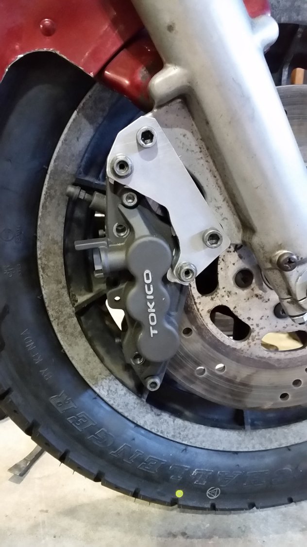

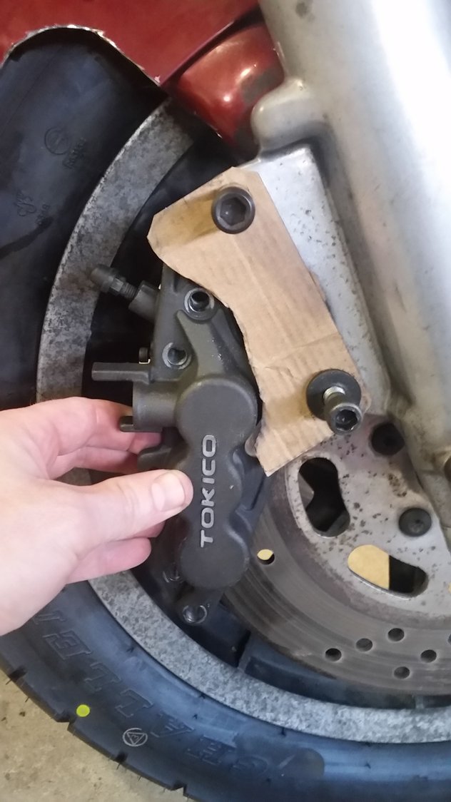

Also, Hayabusa brakes. Machined some adapters using my shitty China mill:

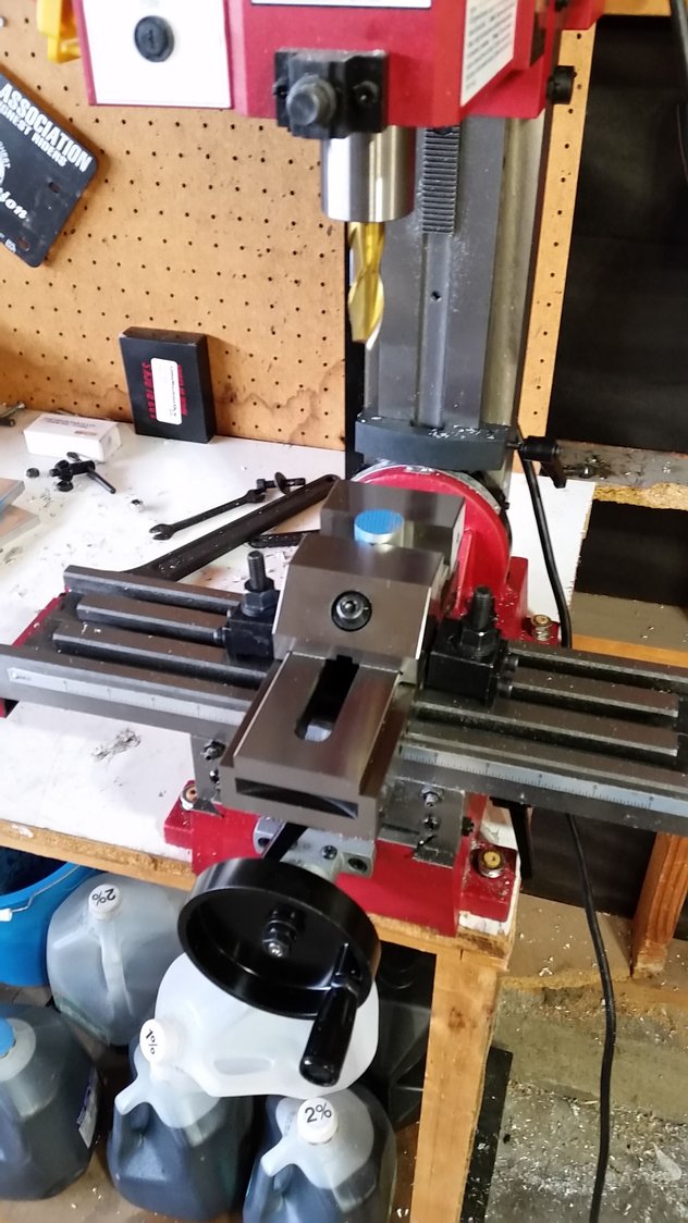

LOL. I never said shitty.. it's just a cylinder head.
Is that 6061?
Old Mar 17, 2018 | 06:23 PM
  #209
Mattbastard's Avatar
Mattbastard
Joined: Nov 2009
Posts: 4,315
Likes: 1,663
From: Tampa
Originally Posted by Mr-Mike
Is that 6061?
Yup. It's all they got for aluminum at Industrial Metal Supply in San Diego.

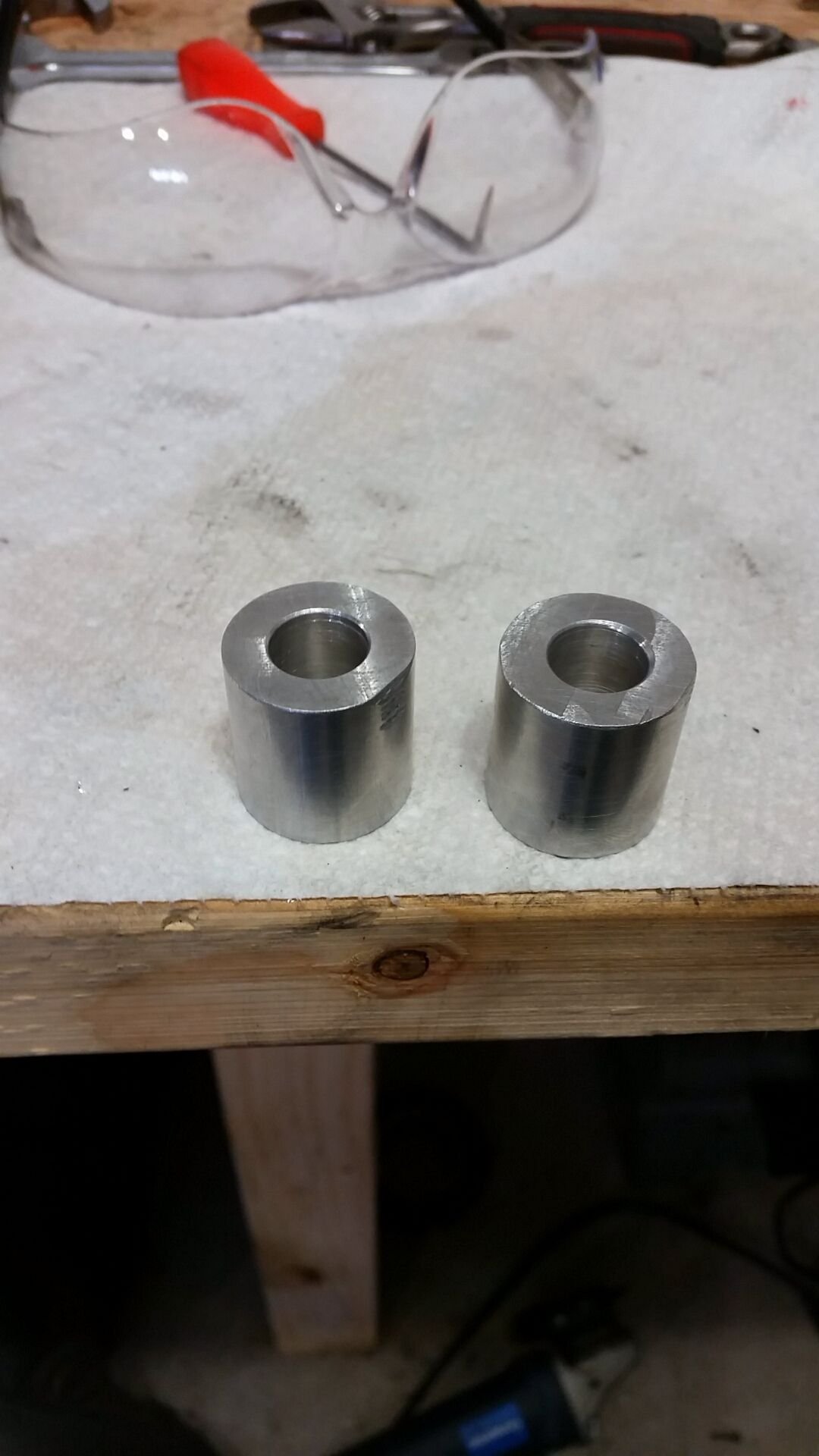

Speaking of milling more aluminum, carb bracket spacers:

Them little f&%kers would have cost me $40 from McMaster Carr, and would have been made out of some hardened steel that would have eventually rusted. I got a whole foot of that AL stock with like 9" left over.
