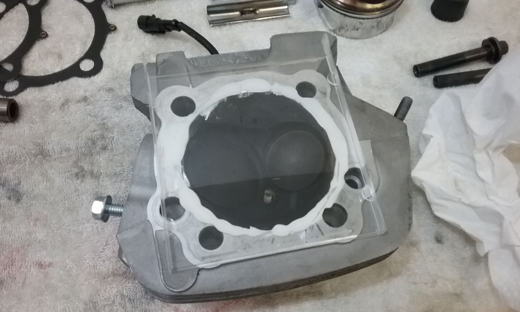

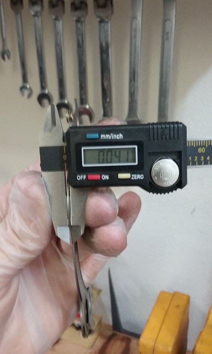

Getting things back together, but being a LOT more meticulous about it. For starters, knowing EXACTLY what my compression ratio is
Finding TDC:
Using a depth gauge to see how far under the deck the piston is
Silly putty in the valve relief, then put in the burette for volume
Burette, 100ml. Got it on Ebay for like $20
Head Gasket thickness
And checking the combustion chamber volume. FWIW, dead nuts on the money from the build sheet from Hammer, 91cc

If those are flat top Pistons, which they appear to be in the pic them the Pistons would be +1.5 cc for the valve reliefs...
Yes, you're correct on the volume, but the cavity from the valve reliefs warrants a negative value in that cell. Notice the calculator is calling it "Dome volume", hence the negative value. Back with my old pistons I used +6 since the domes displaced 6cc over the top of the piston crown.
