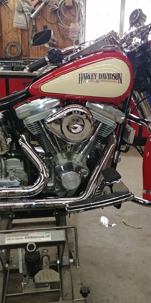

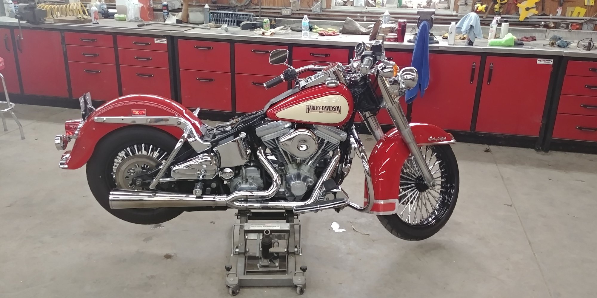

So heres a little update along with some pics after i got it all cleaned up.
ive only been able to put about 20 miles on it becasue winter in Wisconsin just wont give up.... But im really happy with the way it runs. I left the jetting the same as before in my super e and it feels pretty good but when the roads clear off i will run it and do some plug checks. Currently running a 28 pilot and a 70 main.
Definitely a little more valvetrain noise with this cam. I would compare it more to an irate sewing machine vs the normal pissed off sewing machine lol.
Old Apr 21, 2018 | 10:17 PM
  #96
1997bagger's Avatar
1997bagger
Posts: 5,081
Likes: 2,159
Good looking machine, is that a older Propipe with a removable baffle?
Old Apr 22, 2018 | 05:49 AM
  #97
spanky02's Avatar
spanky02
Joined: Jul 2012
Posts: 204
From: linden, pa
THat looks like the older pro pipe. I had one for my dyna. I wish I could find one for my road king. Good looking bike by the way!👍
Old Apr 22, 2018 | 06:07 AM
  #98
98hotrodfatboy's Avatar
98hotrodfatboy
Posts: 21,116
Likes: 7,638
From: Poolville
Hey, congrats.... On the jetting I would definitely bump the intermediate let to a .0295"... Better a little rich than a little lean. Don't need that on a break in....
Old Apr 22, 2018 | 07:41 AM
  #99
splattttttt's Avatar
splattttttt
Posts: 5,649
Likes: 430
From: MASS_hole
The header section of the pro pipe is a close resemblance to the rush system
but the muffler sections do not
Old Apr 22, 2018 | 02:02 PM
  #100
Farm Shop's Avatar
Farm Shop
Joined: Dec 2014
Posts: 268
Likes: 69
From: Edgerton Wisconsin
Thank you! Yep this one does have the removable baffle. Not sure how old it is i picked it up used a few years back.
