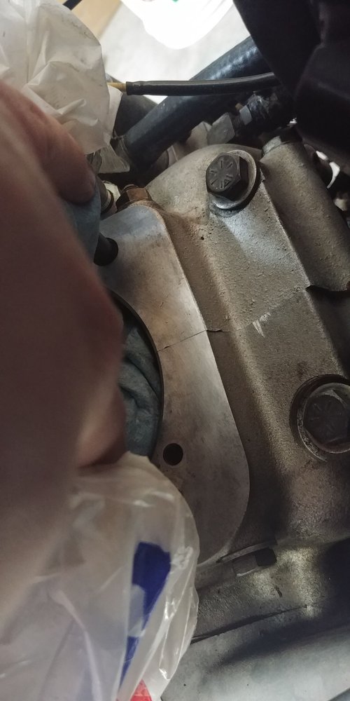

Do you guys put a dab of gasket sealer where the case halves meet before putting the base gaskets down or dont they bother? Ill be using cometic steel base gaskets.

I never have and I change cylinders like I change my underwear and never had a leak.....

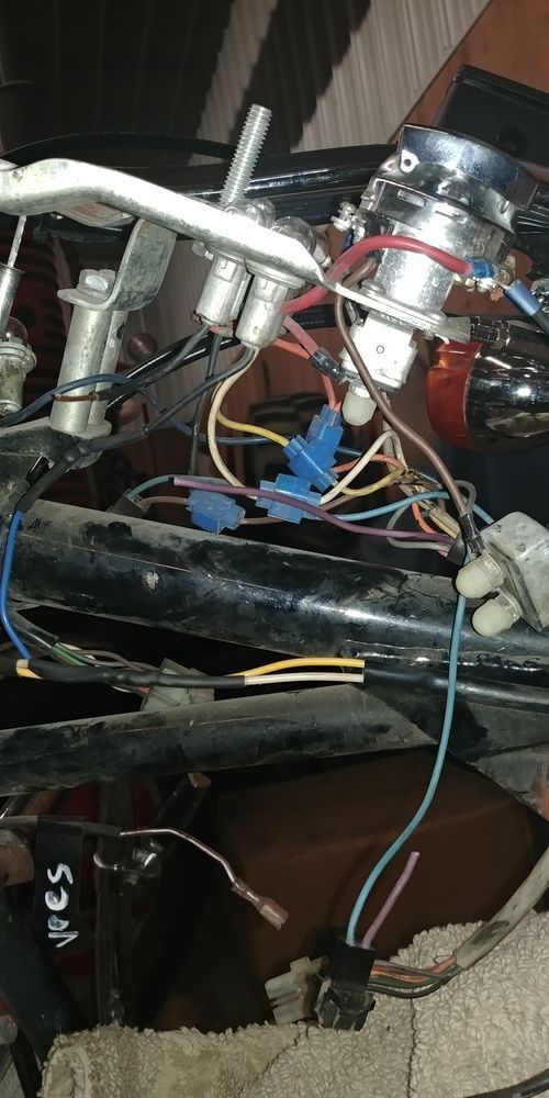

Originally Posted by glidein wide
yes.... Mine....
My 1990 Springer looks exactly like that! I always thought it was a hack job from the previous owner...
