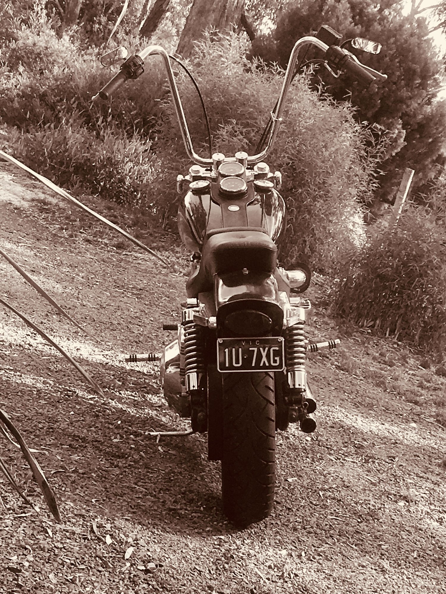

Old Jan 10, 2018 | 05:39 PM
mac22's Avatar
mac22
Joined: Dec 2017
Posts: 23
Likes: 5
From: Australia mate
Thanks for the info and welcome from you all. I’ll be going to see the fella I deal with in the very near future for the engineering side.
As for pics the best I can do atm is this
