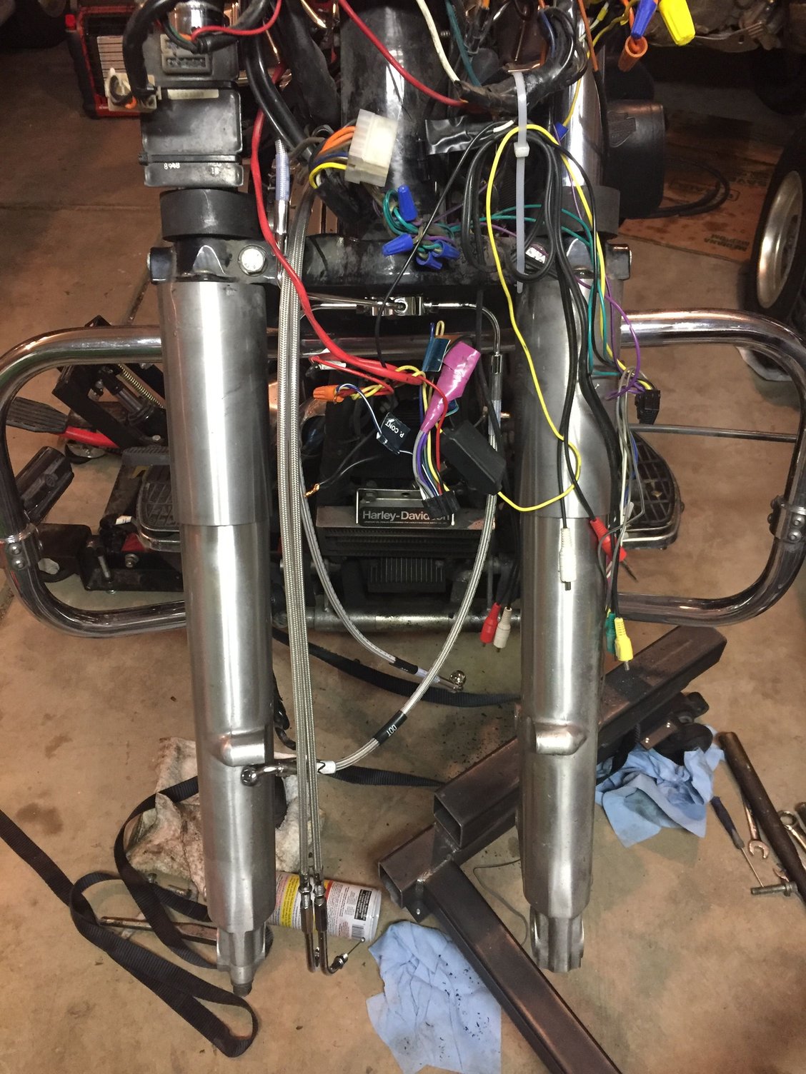

Old Feb 11, 2018 | 05:43 PM
husky390's Avatar
husky390
Joined: Jul 2017
Posts: 93
Likes: 10
From: Colorado
Forks are back in, relocated the ground block, installed new brake lines, and am waiting for the bumper repair kit to cure before I reinstall the inner fairing.
Old Feb 11, 2018 | 05:47 PM
TSheff's Avatar
TSheff
Posts: 11,322
Likes: 3,661
From: SE Texas
I would rethink all those wire nuts. It's not that head to solder and heat shrink and definitely better than going back in because of a poor ground or bad connection.
