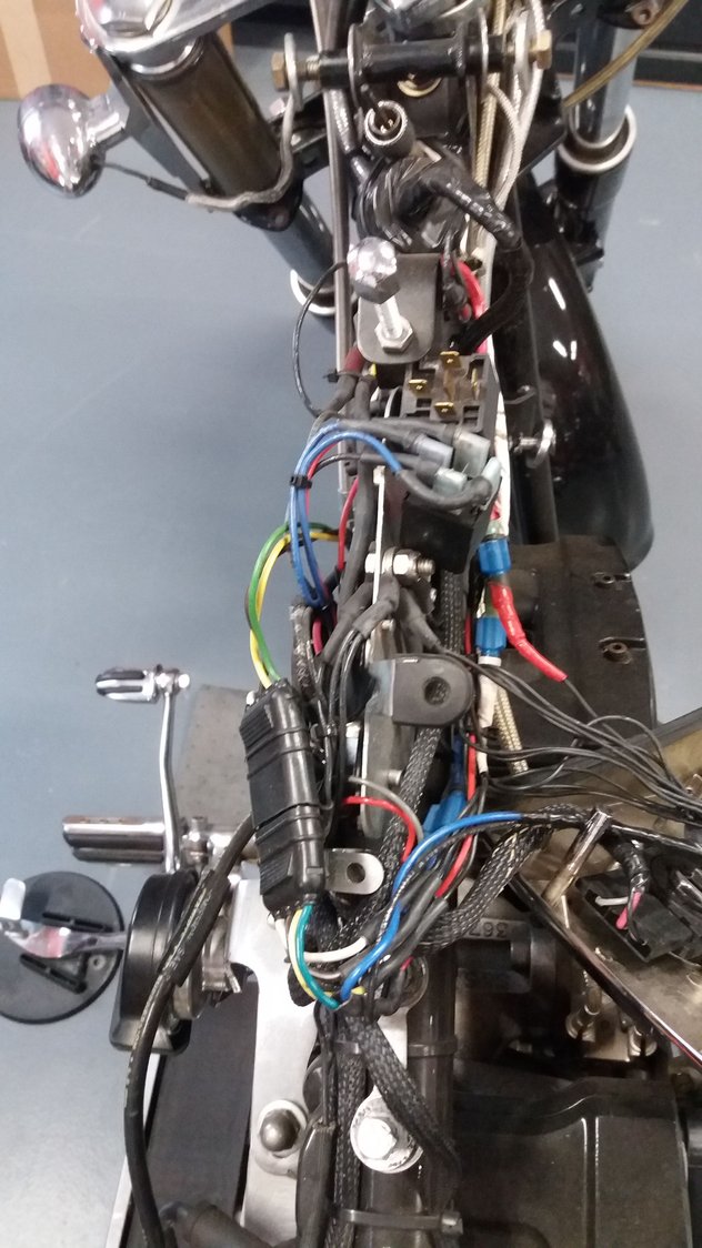

Old Mar 5, 2018 | 09:22 AM
Abandoned's Avatar
Abandoned
Joined: Feb 2012
Posts: 574
Likes: 15
From: Carolina
As Tim said. Do you have a spot to mount the speed sensor in the trans? Also a 98 Fatboy only had three wires going into the back of it. W/g, black and orange/w. There should be a 3 pin deutch connector between the tanks...
All the wiring was redone previously. There is not much left of the original wires. Also all the connectors have been removed. I attached a pic, the wirings in pretty terrible shape.
