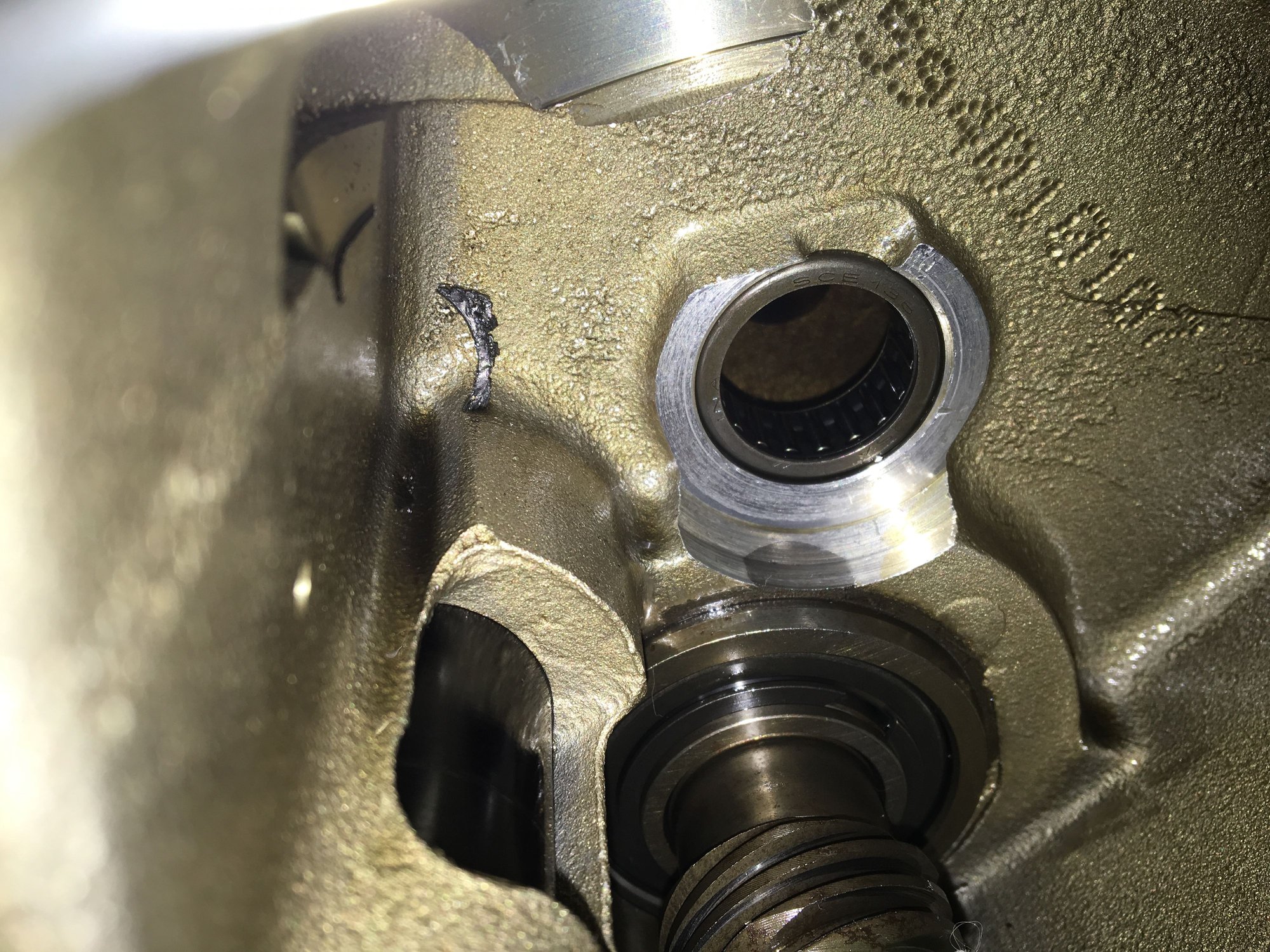

The best photos I could get of cam bearing.
Does look like a INA after all.
Old Jun 3, 2018 | 03:21 PM
Yankee Dog's Avatar
Yankee Dog
Posts: 3,728
Likes: 3,073
From: Brighton, MI
Looks just like the stock caged bearing (not full compliment) I removed from mine a couple months ago. YD

Yup, yank that POS

After a lot of time waiting on parts and trying to find the time....she is alive.
New cam bearing, top end gasket kit and nice new Mikuni carb.
Thanks to everyone that gave me help through this (little) fix up.
