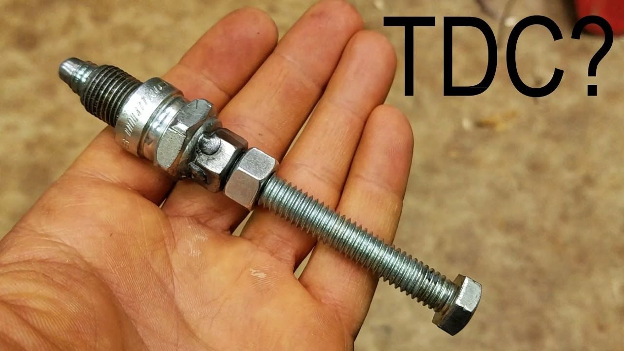

Use a piston stop tool to find TDC.
Easy to make out of an old spark plug.
Set it to stop the piston a few degrees before TDC, make a mark, rotate backwards until the piston contacts the stop tool again, make another mark, TDC is halfway in between, same method to set up a degree wheel.

Great idea-my heads are currently off so it will be pretty EZ
I was hoping to drill the timing plate by Daytona TT takes up all the room there...
