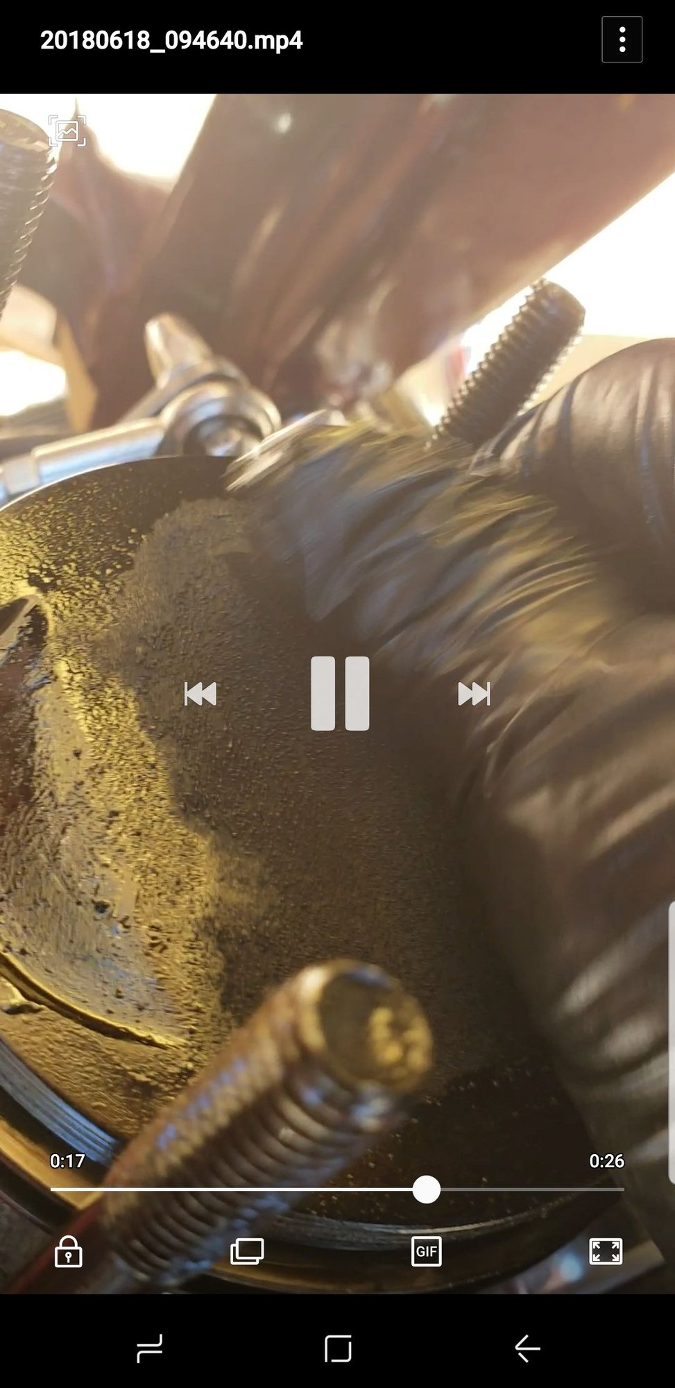

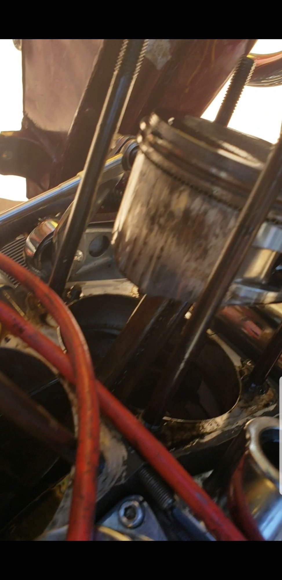

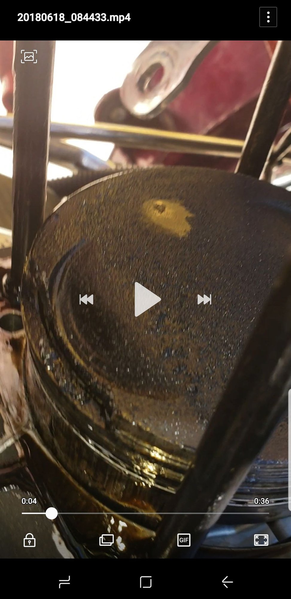

That's what I said. Im not sure what they did. Rings look to be in the right way. I dont think they flycut the relief pockets in the pistons deep enough. There is a piece of rear piston missing and the exhaust side is scored pretty deep.
The front cylinder had 1 loose head bolt. On that piston you can see where the intake valve was making contact with the piston. It is deeply scored on intake side. Both cylinders will need to bored yet again.
. The shop is closed today so I will be calling tomorrow. I'm stuck in the mountains until I can get fixed. I'm sure they will try to find every way possible to lay blame somewhere else.

It appears the shop neglected to "check all clearances". W9B is a high lift cam & those monster valves in the STD heads introduce valve to valve & piston to valve clearance issues. No easy job & you just can't ignore details when setting up a combination like this. Hope you get it worked out, OP.
