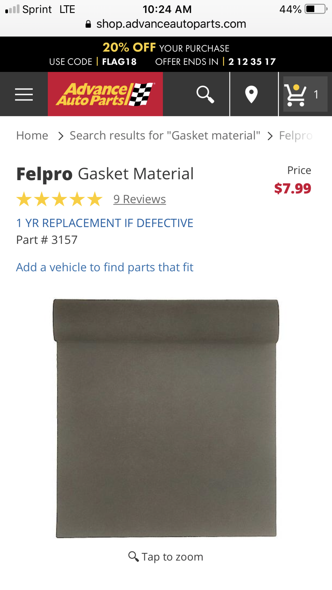

.030 - .040" thick. Install the manifold cold first with-out anything and see the amount of play, and go from there. Everything will expand and squeeze with heat, The old compliance fitting torque is 60 inch lbs.; I torqued the manifold to the heads to that value, then snugged it a little more. About 1/8 - 1/4 turn. When it feels tight, stop.--------------------RJ

I don’t know why I’m excited to get home and make some gaskets and install this thing...lol
i installed it cold without gaskets yesterday and didn’t have any gaps when snugged down. Didn’t torque it just yet.
Will this work? doesnt have a temp rating...1/32 thick.
